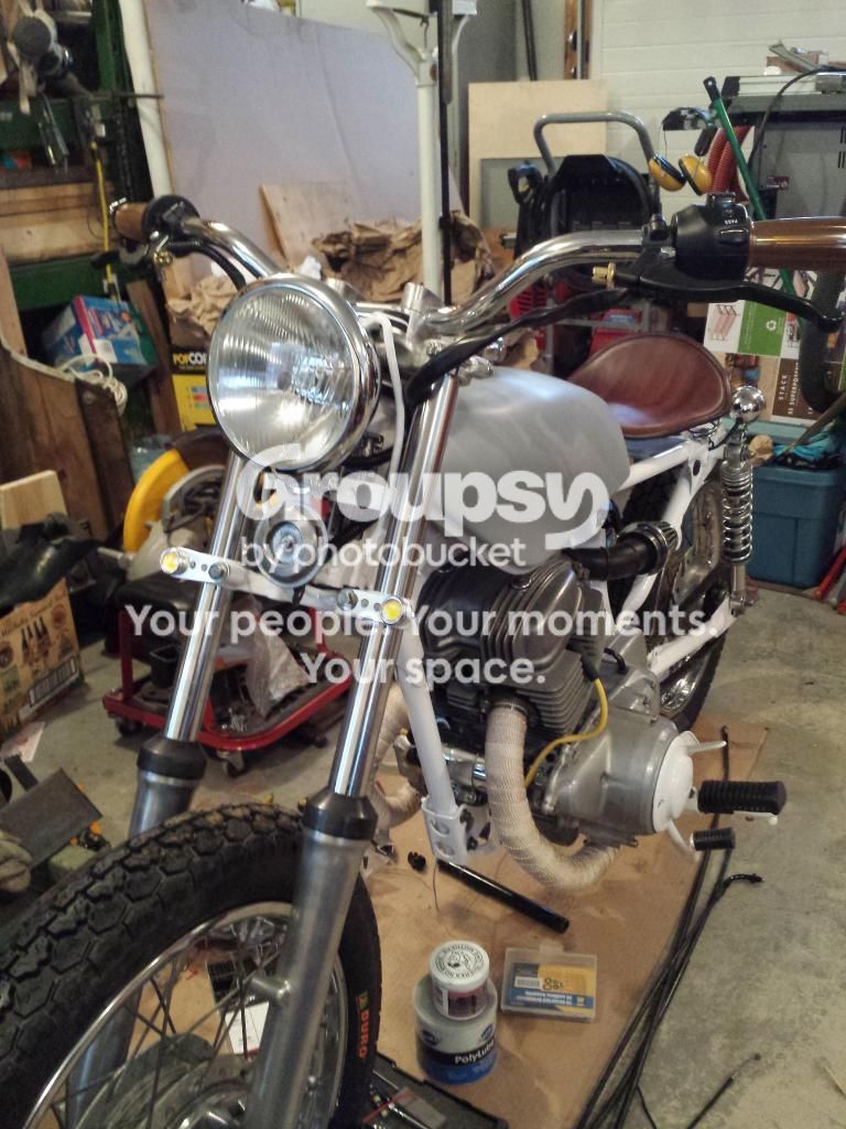

What I've been working on is my custom wiring harness for my project bike, a 1979 Honda CM185, its a 6 volt bike and I wanted to run LED turn signals and brake light, so along with doing the entire bikes wiring from scratch, I included a 12 volt power pack wired in separately to power the lights. Ive got everything done and the last thing was to wire in the flasher relay I bought (Grote 44891). I think the draw from the LED's I'm using is too low, as when I try the switch they light up very dimly and don't flash, when I connect the ground wire on the relay, they don't work at all. I know the lights work fine because when I wire them up without the relay the turn signal switch lights them up nice and bright, just obviously not flashing.

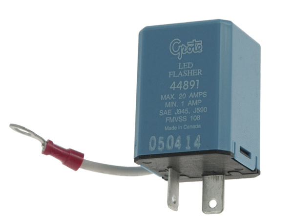

Just looked up that Grote 44891 flasher.
On the case it says minimum current draw is going to be 1 ampere. I'm pretty sure your LEDs are well below that.

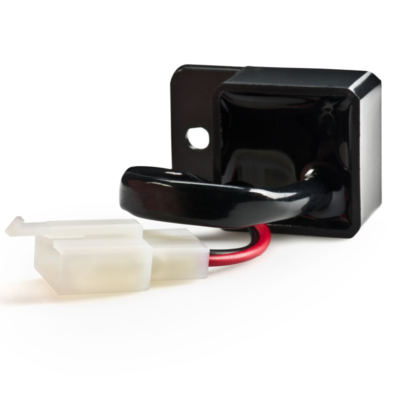

Get one of these.(Below) It will work without the minimum 1 amp draw requirement.
https://www.superbrightleds.com/mor...cle-electronic-flasher/787/842/#/tab/Overview

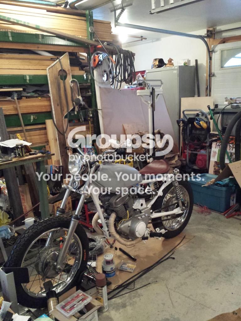

She's a little bit of both a restoration and custom build.. Hoping to finish it over the Christmas break, my time in the shop is going to be coming to an end soon as my dad wants to get a boat in there
