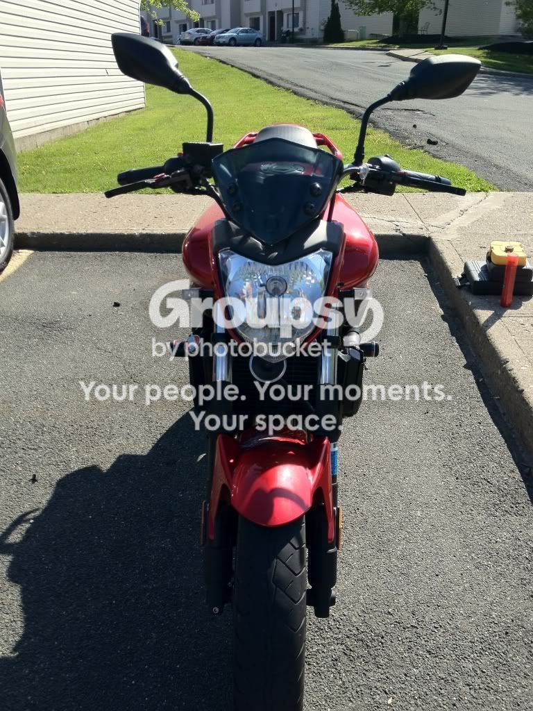

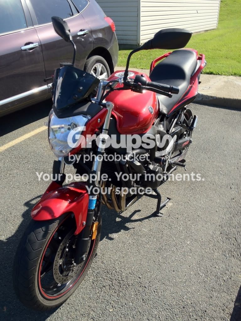

So got some time this weekend and installed my VS-01 kit. Wanted to post up a few pics to share.
Before (as we all know..)
And after:
I am not a fan of the mirrors supplied and am looking for some alternatives. I wasn't really sure I was interested in tapping the master cylinder for one mount and purchasing the clutch perch for the other side, and I don't like how far in they are currently mounted in order to avoid controls.
I kind of like the ones shown below (I stole the picture from S.D. Willie) but am not sure what bar ends can be purchased as to not have to shorten or move the grip, yet are heavy enough to avoid vibration. I don't know if bar end would be the better bet, or if going the extra mile and tapping the master cylinder and buying the FZ6R (I believe?) clutch perch would be a better route and purchasing new mirrors to mount in them. Any suggestions are great - been using the Search a lot and there is an overwhelming amount of threads related to mirrors...
