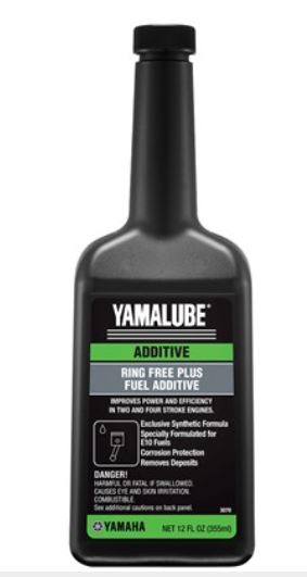

Randy, has a post (Randy, if you could please re-post, the procedure for cleaning the injectors and flushing the fuel rail?)
If your hesitant on pulling injectors, etc, depending on how bad (if they are clogged) they are, Yamaha makes a product called "RingFree" which works excellent cleaning the fuel injection system and top end of the engine. 1 oz per 10 gallons however when I come across an engine that'll barely run, I'll run a very heavy dose of it and a good part of the time, it'll clear out the crap (depending on what it is). Sitting over night and more running with the product will help it work better over time... I run it in every gas engine I own. A good, preventive maintainance product to use, IME...
