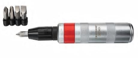

Just to be safe I would buy the 5 bolts. Use an impact to get them off. Even a manual hammer driven impact would be better than just an allen wrench. Use a torque wrench to specification on the reinstallation.
12,531
1,176
To add, use a hand, impact driver tool to remove the bolts. They will very likely be loctited in and VERY TIGHT...
I would also take a heat gun to the wheel where each bolt goes thru which will help loosen any loctite. It doesn't need to red hot, not burn the paint off but very warm...
And definitly use new bolts with a thread locker...
"LT" is loctite..

OP, if the Allen driver begins to slip or is rounded slightly you can grind it flat. Just don't get it hot.
Also, if the bolts edges flair up a bit, use a small round flat tip punch and beat them down flat. The shock will also help loosen the bolts while semi-restoring the allen cap shape.
