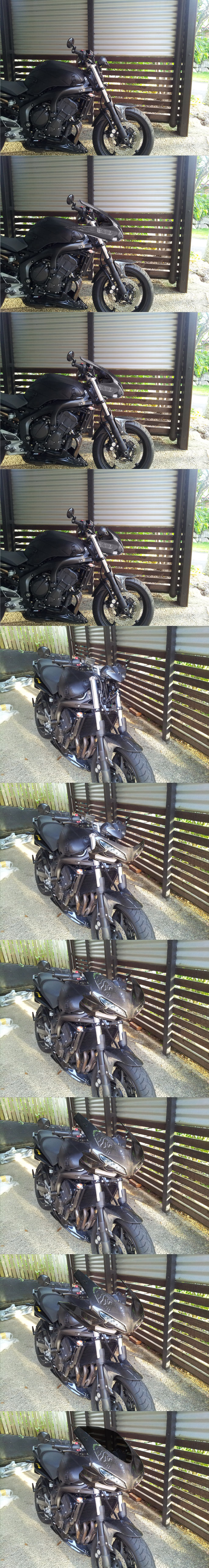

So, ripped the headlight off, mounted the CF fairing on the stay and the light... fitment around the light is a little dubious... sigh. Not sure if this is due to aftermarket headlight stay, aftermarket CF fairing or combination of the two... either way not much can do about it....
Placing the fairing stay near the bike... it's clear that it needs a good 5 inches or so cut off it, stuck out way too far ...
Additionally the screws provided for the mirrors wouldn't go thru the fairing and the stay... so couldn't put those on to see what they'd look like - off to a hardware store tomorrow to find something to replace them.
So more photoshopping and looking at the bike to come tomorrow... might also put the headlight on without any faring and compare that too. Hopefully I like the fairing more :rolleyes: otherwise what a waste of time haha :thumbup:
Anyway ripped the fairing stay off, held light in place by hand then photoshopped myself out of the pictures and then cropped the fairing a bit to see what it could... potentially... look like...
Anyway... penny for your thoughts:

When working with aftermarket parts, this kind of issues will happen more than often... :(

I might know another configuration that might look sweet on your bike :cheer: If you can give me both sets of pictured I could give it z go :rolleyes:
What I can tell, is that you will have problems to clear hour handlebar and controls...
Maybe clipons will do the trick ;)

Yeah, I'll see if I cannot get you a decent shot... but basically the issue is the top of the light gets stuck a bit behind the fairing, doesn't sorta pop into place like the bottom does. Even without having the fairing stay... so I guess it's more an issue with the CF... will go pull it apart and take some photos now.

The fairing clears the handlebars without issue, it's the bottom of the fairing that needs clipping, if mounted to turn with the bars... even if it isn't it looks odd without cutting it back. Well it does when the light is mounted as high as it is in the pic above.
It's dark now so no more bike pics today... need to get the screws for the mirrors too, want to see what they look like on the bike.
I don't mind the side profile of third image... well third shot in the one image :rolleyes:

I'll see it on the pictures, but sounds like you will have to trim the fairing a bit at that place...
Have you fixing the top part of the headlight first? (possibly you'll have to work in a specific sequence to get everything mounted correctly..
I have tried pushing it in differently.. stretching it a bit... it does have some flex ;) haven't had much luck with that... guess I'll go try try try again.
Will try to avoid shaving it, as I don't have the correct tools for that... :ban: guess I could get some - I do need/want them!

Essentially the bolts provided are too short to start gripping the thread in the actual mirrors... the mirror threading doesn't start for about 4-5mm inside the mirror... the bolts are about 8mm in thread length... and the fairing stay + CF and rubber seal thickness is about.... 8mm or near enough haha... doesn't even get close to gripping. Besides, you'd want more than half a twist anyway... that'd be asking for trouble :)
Just remembered another issue with fixed headlight, the speedometer cluster etc.
That turns with the forks... and will possibly hit the fairing/light... so that will also need to be dismounted and attached to the fairing stay.
