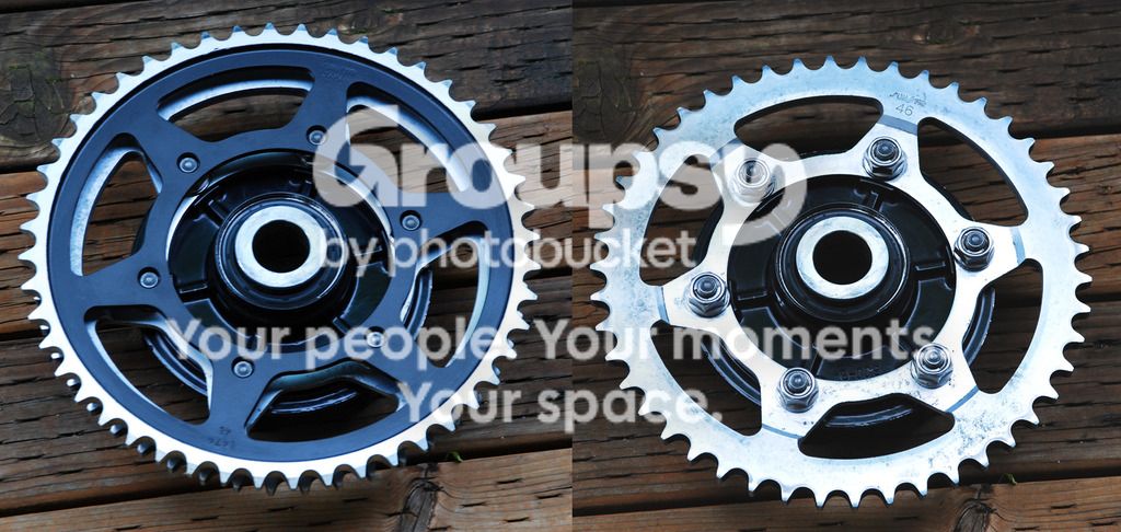

Anyone looking to add some teeth, consider this....
Much lighter than OEM 46 tooth...
"Sunstar 2-547448 48-Teeth"
