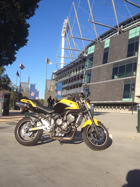

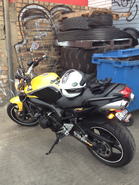

I bought a 2nd hand grab rail that had blue mettalic rattle can sprayed over the rough sanded original lacquer. I hit it with stripper ,let it sit and thenwire brushed it to roughen it up for the next coating oce it had well bubbled i sat it in a big plastic tub of hot water and caustic soda( drain cleaner) and attacked it with coarse steel wool. Took quite a few goes until I got 99% of the paint off . But the oainter was very happy with myprep work
The grab rail is now same colour as the tank
