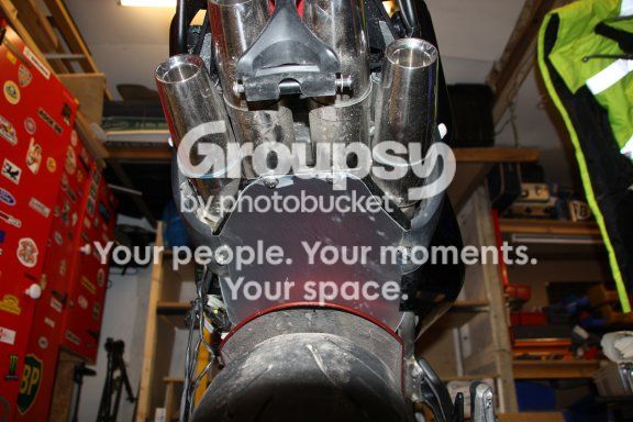

Hi to all, having fitted Laser Extremes to my Fazer, i found out that the amount of crud that found it's way under the seat, as no undertray exists for the Fazer, i got to it and made one, here's a few pics.

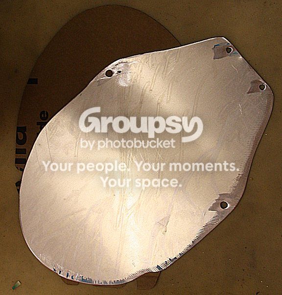

1mm ally sheet.
Does it fit.

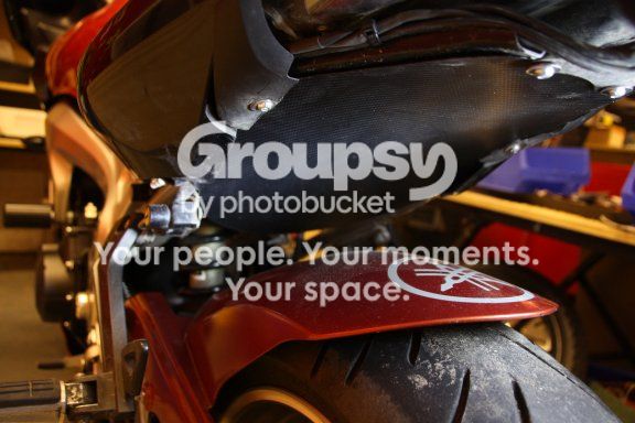

Now in place, with heat sheild on top and finished in carbon wrap, to be finished of with black dome heads.
put some load(driver and pillion) on bike and watch rear hugger!
if both are lightweight tell them to jump little bit :)
btw.
i see that you have painted rear hugger so put something on it to protect the paint!
