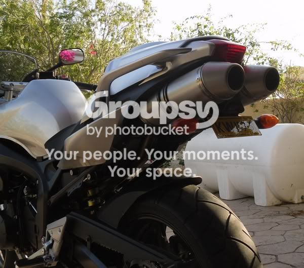

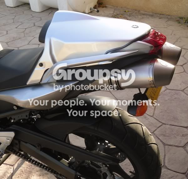

Leos without stickers as promised...
And my newly hacked tail tidy with new numberplate...

Man, that looks REALLY nice!:thumbup: Looks like the bike was supposed to come that way.
