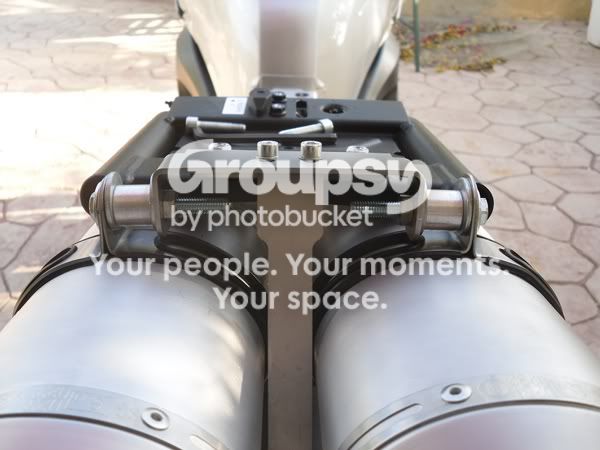

Halfway through the installation of mine... The pictures at the beginning of this thread were invaluable as the 'manual' is fairly useless...
Started her up today and the sound is awesome!
However, the alignment wasn't correct and I couldn't get the hanging bracket in the gap (the longer pipe was too far towards the middle of the bike) so I have taken it all back to the cat eliminator again... then it rained...
Hopefully get it up-and running tomorrow...

I've now fitted the pipes 8,247 times and I still can't get it to line up properly! :(
I have to say I'm unimpressed by the mounting clamps - they seem too soft and pliable for the job.
I'm about to strip the whole thing down again and start over. Good riding weather too!

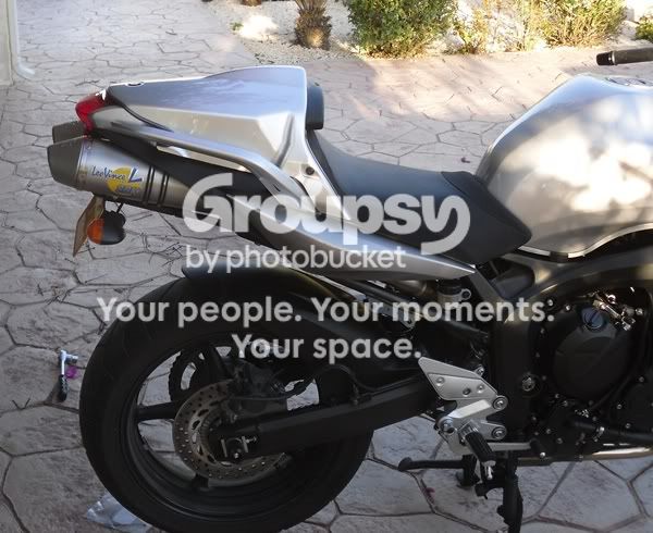

Success! :cheer:
It has taken me all day...
Thanks for the advice Jman - I tried that but no matter how I tried to align the pipes I just couldn't get it to work...
In the end, I replaced the bolts that hold the clamps with longer ones and 'packed' out with washers to space the pipes.
I don't know if it is just manufacturing tolerances or what could have caused the problem but I can't see anything I have done wrong...
Obviously, if I realise a massive mistake later I will confess all.
My overall impressions tho are that the brackets and clamps are not really fit for purpose and I'm not convinced that the whole thing won't come apart while riding.
Does it look good? Yes :thumbup:
Does it sound good? Fantastic! :thumbup:
Would I buy another LeoVince? No. :shakehead:

Keep looking at my pictures and yours. Can't figure out why you had to space them out further.:confused: Sorry to hear it gave you such a rough time. It does look sharp, though.
cyprusgrump
Aug 27, 2009
82
Cyprus
www.virtual-pub.com
Thanks for your kind words! :thumbup:
I was looking at your pictures all day! Even printed them out and stood comparing them to my bike - I figured I must be doing something wrong!
Will get to ride it tomorrow - hopefully everything will be okay. At least I have the confidence to take it all apart now and re-install or adjust if it needs it...
