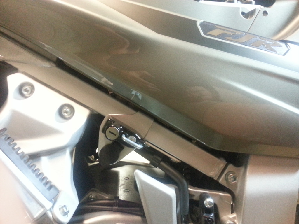

*The silver on the below FJR frame is the same color as the FZ handle-bars. The bracket shown has the above Rust-oleum paint applied to it:
