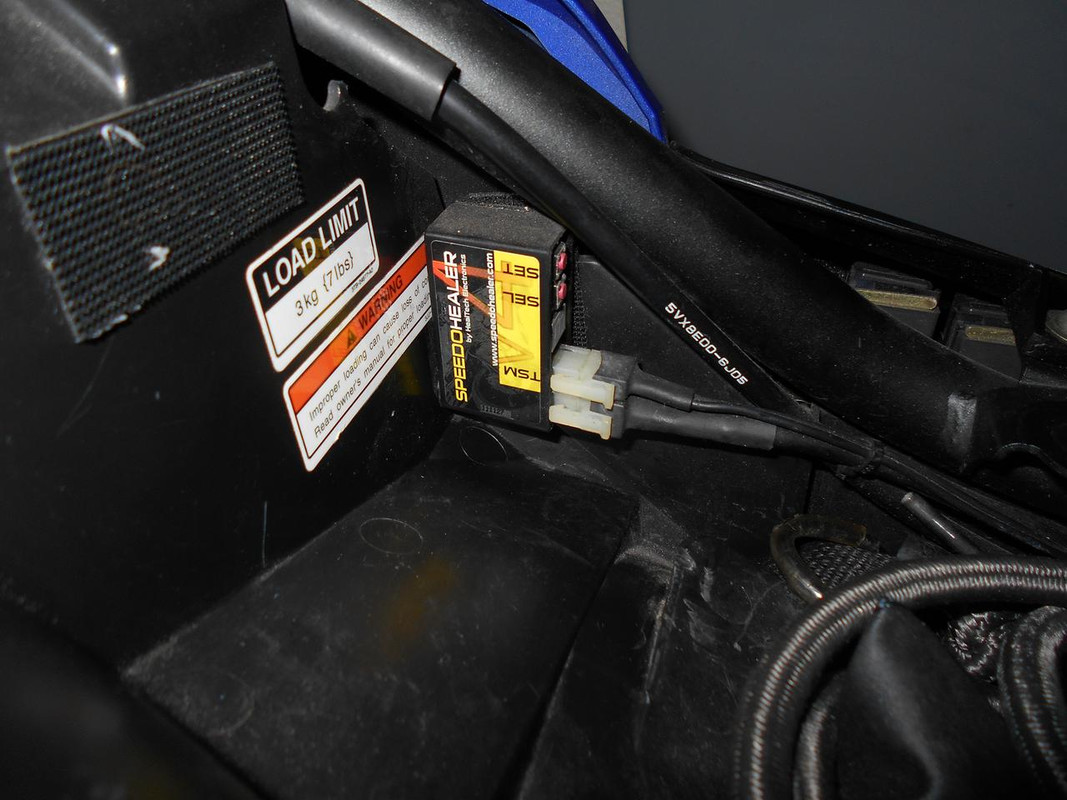

Should be under the tank and be plug and play. Directions should be included with the Speedohealer.
It'll take longer to program than to install...
It comes with plenty of wire. I mounted mine under the seat for easy access and setting. The second line is to be able to display (and erase when you want) your highest speed- it's for a remote push button):
