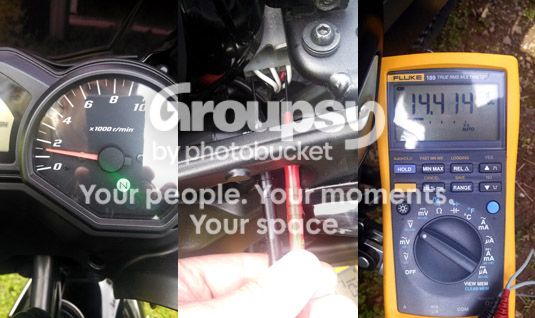

Do the blinkers, high beam, basic LED indictors work?
Do you have an ohm meter or test light?
You may need to test the wires continuity from the ecu to the gauage and also confrm that wire is not shorted to the chassis.
Because this is a conversion, you could test from this connector here too..
attachment.php

In detail, what does work in the gauge cluster, anything else? Grab a FSM. It has a schematic in it....
At a glance Red/Green trace is battery backup to keep the clock alive. Hint it is hot all the time so nothing should be connected to it or your battery will be killed when you walk away from the bike.
Red/White trace is Ignition power fused at 10A and also powers the gauge. This is tied to Red/Yellow trace which powers the backlight LEDs which you say work. Verify it is in fact battery voltage and not something like 4.2 volts which would light the leds but not operate the gauge. A bad connection could do this.
If it has power in and the Black/White trace is grounded to the ECU as it should be, other parts of the gauge should work.
Again, do you have a hand held meter or test light???
