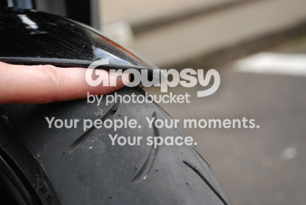

Gap with R6 forks and Stock FZ6 Fender. . . One finger and yes, if something sticky adheres to the tire it gets clipped by the fender or ground through. . .
