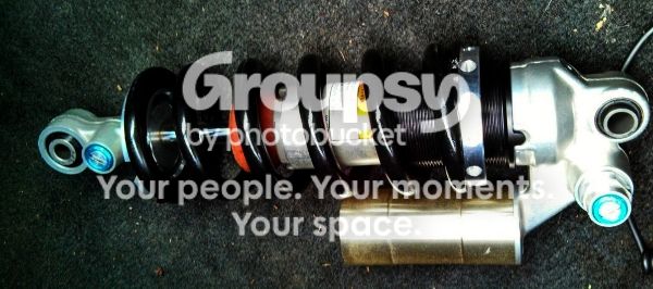

FWIW: The shock can be used successfully. However you'll get the most from it if you revalve the shock and install an adjustable collar! If you just use it as is, grab the S/A and keep the link. Then the valving can be left alone and replace the spring for the fizzers extra load!
>>CLICK>> Otherwise it nearly bolts in as is....

The guy that re-valved my shock hit a home run on the first go round. If you choose to take that path, you need to give the tweaker all the info you can about what it does as is and what you want it to do.
In this case its being used in a direct action mode and it lacks proper damping control as is. You must increase fluid flow and control so the valving is back in a usable range of operation.
Perhaps its been long enough now that my builder dude will release the recipe so others can give it a go....

To tailor the shock to our bike the shocks internal valving needs reworked. Once the spring is off and the nitrogen is bled off the shock body can come apart. Behind this nut is the metering orifices, valves, and shims stack that control the oil flow when the piston moves in the body. The opposing ends of the shocks body have the user adjustable valves to tailor the rate of compression and rebound travel.
When I get the details of "What was changed" internally to the valving I'll edit this and add them should someone wish to have their suspension guy rework their shock. But its primarily about adding/removing shims to tailor the rate at which oil flows through the piston to the other side.
2013-06-03, I'm going to try and keep the TOP TWO POSTS with all the FACTS. What do you need to do to make this work. Other posts below this point will be details of how and why I did what I did. So if you want the details, I may have them below.

He never did. Matter of fact he still has a shock of mine!
Talk w you person and if they understand valving & damping needs, chances are they can get it pretty close.
I know oil used was slightly higher viscosity and the charge was more than stock to reduce aeration.
Mine is still working good but the dang bump stop is deteriorating. I might have to pull it to fix that.

Last I looked small parts were still available new; i.e. bump stops, bladder, seals, piston wiper.
