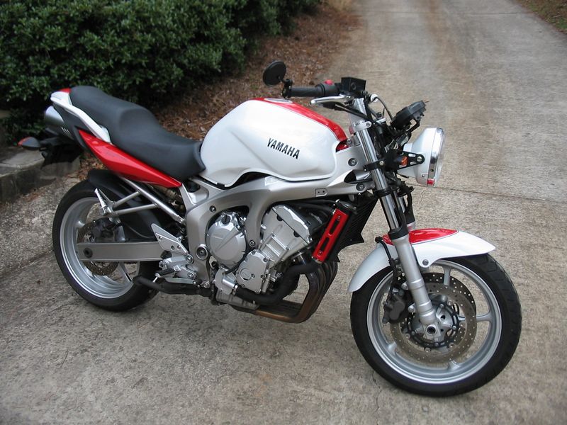

New member here, just picked up a 2009 FZ6 with just 440 miles on the clock. I'm a little disappointed with the bike so far, but it's mine and paid for so I'm moving on with modifications. I want to replace the ugly factory fairing with a conventional, round 7-inch headlight.
Using the search function resulted in an overwhelming number of threads, so I'll throw out a few specific questions here.
1.) Most aftermarket headlight kits I find are overpriced. Are there lights/brackets from other bikes that are easily retrofitted to the FZ6?
2.) The FZ6 uses two separate bulbs for low and high beams. How is this addressed with a single light? Are wiring/fuse modifications necessary?
3.) I prefer bar-mounted mirrors on stalks over bar-end mirrors. Any common choices for this conversion, both aftermarket and from other bikes?
4.) I'm no fabricator; any custom speedo brackets available to pull the meters closer to the bars? Has anyone done away with the digital display altogether and mounted an analog speedo/tach set from another bike?
I want the bike to look as factory as possible post-conversion. The cleaner and simpler, the better. These are two good examples:

Well first off welcome. The most common conversion used here seams to be the vs-1 or vs-2 kit sold by a member here that's what I have it is all Oem Yamaha of India. If you want a single round I suggest eBay you can find the speedo bracket from another member lean69 I think. And for mirrors I have Oem fz8 mirrors on mine with a fz8 clutch perch and I drilled and tapped master cylinder for right side. I will post pics later

1. Contact Vishnu (dev_usc). He sells a naked conversion kit that comes with everything you need and it is all OEM Yamaha parts off of a Yami FZ16, a bike offered in India. I got the kit shipped to my front door in NY in less than 2 weeks and it costs me $325 total which is a steal.
2. Vishnus kit comes with a 35 watt H4 bulb that works with the stock wiring, no real mods required. Unfortunately with this setup, low beam setting illuminates the low beam filament, and high beam setting illuminates both. This is fine for a low 35 watt bulb, but if you want to up the anti with a 55/65 watt bulb, you will find yourself blowing out bulbs often due to overheating. What I did was contact Cliff (Motogiro) who has designed a custom relay to solve this problem. Easy installation, and affordable.
3. Vishnu's kit comes with a set of Yamaha bar mounted mirrors that look just fine. Personally, I like bar end better, so I went with a set of Rizoma knock offs from RideItMoto.com for around $80. A friend of mine also sells a great set of CRG knock offs for around $100. Both very nice choices.
4. Fabricating a bracket out of some sheet metal is fairly easy. In fact, a member just made a post recently about this. If you go with Vishnu's kit, though, he has one already made that works with both the old and new speedo.
I like this set-up better than the fairing, but I would still prefer a round 7-inch headlight. Is this OEM assembly stationary like the fairing, or does it move with the forks? I can't quite tell how it's mounted. Does it include the back cover for the gauge cluster?
Yes, the VS-01 and VS-02 kits offered by Vishnu move with the forks. It certainly doesnt have that "classic" look of a nice 7" round light, but its nice that its all OEM Yamaha parts that come with painted headlight fairings. You might want to look into retro fitting an SV650 headlight. Could be a cheap solution. The kit does not come with a back for the speedo, but it has that little smoked fly screen to nicely cover things up. Another option would be to forego the screen and pick up an FZ1 backing for your speedo if you prefer the look.

In your opening post you showed two examples of nice clean conversions. Just curious, where did you find the pic of that blue bike, and was there any info on the light as far as what it was or where it came from?

i have the SV kit and love it. its worth every penny. i just installed the Dominator kit (dual 4.25 H4, brackets, fly screen) for a friend (2005 FZ6) just under $300 for everything at Fly-N-Cycle Motorsports - Sportbike & Motorcycle Parts and Sportbike & Motorcycle Gear but theres no bracket for your speedo. Again a good product. 7 inchs is a big light, maybe 5-3/4 imo. what ever you do get good brackets and research the light your going to buy (Google images, youtube before and after, members here with the light you want) there my even be some one fairly local with the set up you have in mind.
