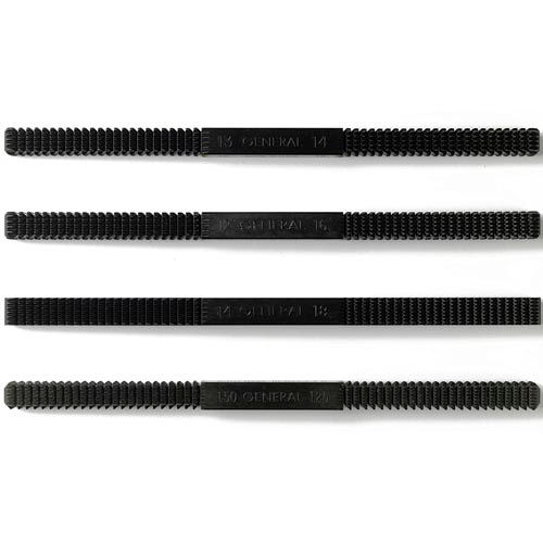

Cheap and good to have around just in case something happens to bolt. Or if you end up cutting a bolt off to fit to length, clean the burrs off with these. Each has 8 different pitches so it should cover most needs.
