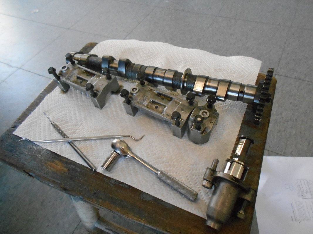

To CHECK the valve clearance isn't really bad To adjust, a bit more, careful work(cam(s) have to come out)..
I don't think I trust any shops to ACTUALLY do the job... At 26,600 miles, I had 2 exhaust valves .001" too tight. I was already there, had shims, and adjusted...
The engine, as stated, is pretty much bullet proof... By far my fav bike, EVER...
