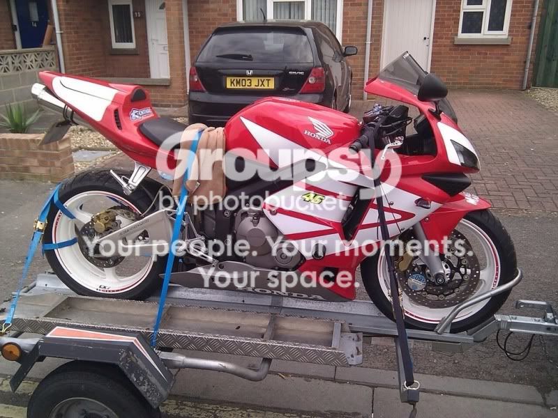

After seeing greg's thread about his new "funday" bike, what stuck out to me is the trailer he has. He says it's the Erde PM310...a single-bike, small folding trailer. I love it and it's something I could really use, but Erde doesn't have a distributor in the US, so I'm turning to the forum to give me some suggestions for another single-bike trailer similar to his.
Here's the one he's got (hat tip to greg for the picture of his bike on the trailer and I included a smaller stock photo of the same trailer)...
I've already got a small Harbor Freight trailer that I've used to tow my bike to Deal's Gap, but it's really overkill for my needs. I don't need a full deck and it's a lot of wasted space and weight. Keep in mind that I've got a Toyota Echo...yes, a small, 4-door, 105 hp car, so weight is a big deal. I've towed my current trailer to the Gap once and it did just fine, but it does worry me that the trailer will put excessive wear and tear on the car that I don't want. A smaller, one-bike trailer like this one would be ideal for my application (which is primarily towing my bike to Deal's Gap twice a year).
Any suggestions on another brand that's like this Erde trailer and available in the US for about the same price (greg's trailer's MSRP is around $750)?

Expanded metal on the bottom would be sturdy but wood you could bolt stuff down to it.
My trailer has an expanded metal floor and it helps when loading the bike on my own, I take it up the ramp in first gear walking next to it, stall it against the front wheel chock then just put the stand down and strap it up.
A solid floor would prevent crud being thrown up from the road but increases the weight.

Hmm...this, along with Andz's picture, sounds like exactly what I'd like to do. You probably would know this off the top of you head...first, where would I go to get the expanded metal and second, what kind of cost am I looking at? I've got a friend here at work that is a welder, so he could actually attach the expanded metal to the trailer, no problem. Thanks, man! One other thing I failed to mention, my car is a 5-speed (manual), so I don't have to worry about the wear on the tranny nearly as much as an automatic. :thumbup:
Andz, that's almost identical to my trailer (obviously minus the floor). That's exactly what I'd like to do to mine. I like the idea of the weight savings, too! Thanks!
