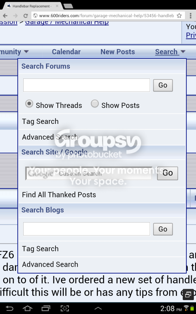

^ scott pretty much covered it all, but this function should help with your quest
Couple good how to's on the forum with pictures and detail.
