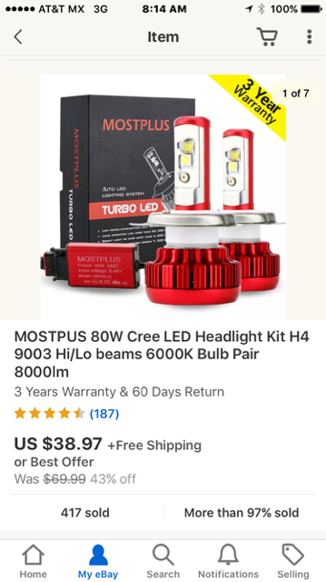

I am looking to buy LED bulbs for my bike. I need H4 bi bulbs. Seeing in ebay i see different rating of 35w 60w even 100w. What do i actually need for this or it doesn't matter ?

Make sure the rating isn't for two bulbs. If they're sold in pairs they usually combine the wattage. The H4 I bought is below; listed as 80W, but they use 40W each.
If the rating is 60W or 100W for just one bulb, that seems excessive. Most h4 halogens use about 65W.

No, you don't need to match the wattage. But stick to something equal or less to your halogen rating IMO.
