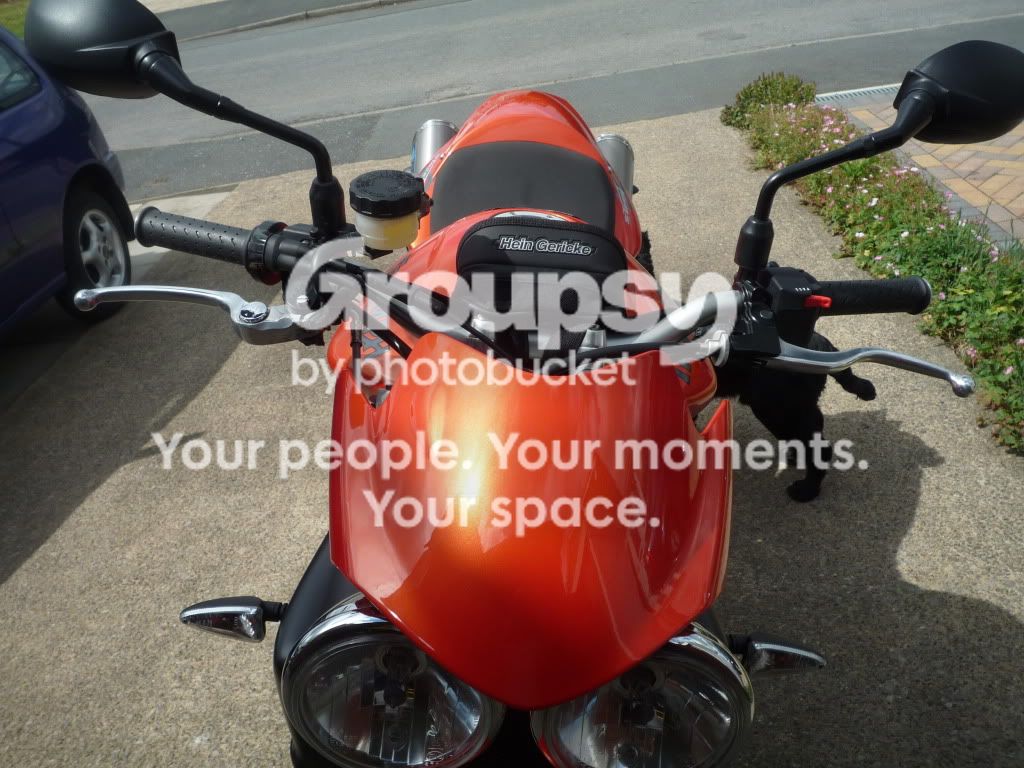

I used to use a solid plastic Otterbox that I had to open to press buttons on. Recently I've bought one of these from Hein Gericke that you may be interested in. In the UK here you're pretty much guaranteed to get rain when riding, so it's pretty much essential if you don't have an expensive waterproof GPS! Trouble is, it would negate a lot of your Purchases! :D It fits fine to a 22mm handle-bar. I've just popped outside to check it with the Yamaha top clamp and it works even better. I had to make something to stop it sliding around with the custom sat nav mounting bar I made up for my bike - but with the Yamaha top clamp it stays in place beautifully!
You can see it mounted to a different bike with normal bar clamps here.
