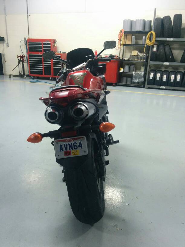

Hi all,
Bit of intro, I bought myself this S2 this summer and starting to look into upgrading it once winter rolls in.
I have heard that S1 headers are upgrades, and is probably going to be my first upgrade. However, I notice that the S2 uses an O2 sensor while the S1 does not.
How do you go about bypassing the O2? Is the o2 reading passive enough to just keep the sensor unplugged?
Any wisdom will be greatly appreciated.
Thanks

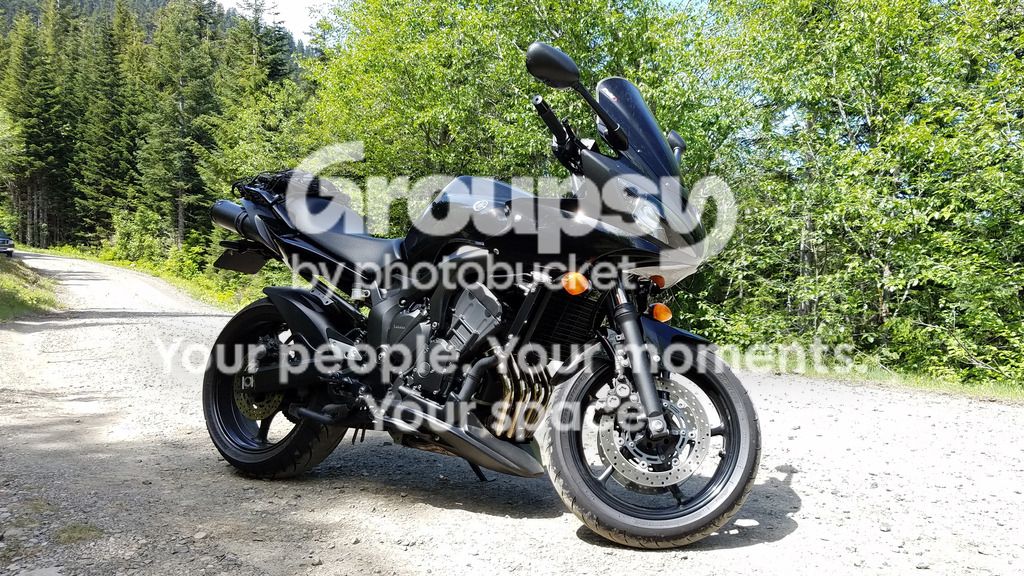

The links and signature answer your questions...
08 Raven w/a few mods...
R6 Forks, R1 Rear Shock (revalved), 6° Ignition Advance, S1 CAT free Header, SS Mid-Pipe, 2Bro Exhaust, AIS block off plates, Bazzaz Z-Fi Fuel Controller & Z-AFM Data Logger, Air Box mod, CR10E Plugs.. .. .. //snip
Weld in a bung on the S1 header and keep the O2 sensor. I ran it that way for a while and then added the fuel controller...
