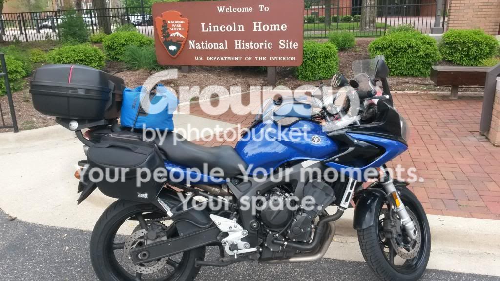

Shot of my bike when I take it camping. This setup has the gear to last me as long as I need; would just need to stop at a laundromat for anything over a week.
-Top case has my sleeping bag, hammock, blanket, & rain gear/jacket&pants liners. Sleeping bag gets ditched in warmer weather, but it got down to 34° at night where I was this weekend.
-Blue dry bag has clothes and food-this will go in the top case when its warm enough to ditch the sleeping bag.
-saddle bags hold tools & camping gear.
-camping gear i bring is hammock & tarp, length of excess rope, knife, gsi soloist cookset, msr pocket rocket stove, 1 fuel canister, headlamp with spare batteries.
-tank bag has sun glasses & clear glasses, wallet, earplugs, side stand coaster, deodorant, toothbrush, soap, Kleenex
-camel back holds my water (duh), first aid, sometimes snacks,
-spare key is tied to my wrist
-I keep a snack (usually jerky) between the dash and windshield to eat while riding if I'm on the express way for a while.

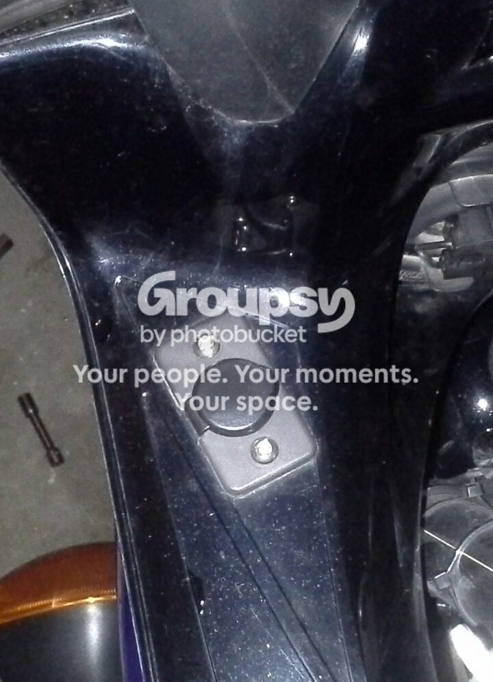

Here's how I mounted my 12V outlet. The 2 charging cables I bring stay in the tank bag.
The camping part should be easy for you seeing as you're a backpacker! Just gotta incorporate it onto the bike. Most of mine are 100%poly. Whenever I see the marines recruiting I will do the 20 pull ups to get the free T-shirt. It's 100% poly. A lot of golf shirts are 100%poly, too, and can be found fairly cheap at kohls. 40\60 is still better than all cotton.

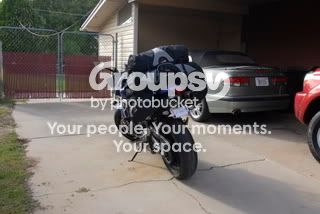

On my recent two day camping trip, my bike did very well considering I loaded it down with way more stuff than I really needed. Much of it was unused. Great learning experience for the next trip where I will bring less stuff.
I did learn a couple things such as I do not like the Camelbak on my shoulders and ended up moving it to my tank bag. I also discovered that the Yamaha gel comfort seat isn't and on the return trip used my Airhawk II seat cushion that I had packed in one of my saddle bags.
My Iphone charger is wired to shut off when the bike is not running. This was an issue as I would have liked to charge the phone while in camp with the bike off. I have a hard wired charging cable that came with the Iphone mounting kit. I also have a 12v weatherproof outlet connected to my battery tender so I think the best solution is to simply bring the Iphone cigarette lighter adapter and charge it that way since the 12v outlet is always hot.
A few photos are attached:
