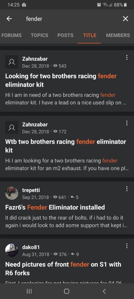

Sorry you didn't get the info you expected, did you look through older posts? - did a short search and found plenty of resources [emoji106]
