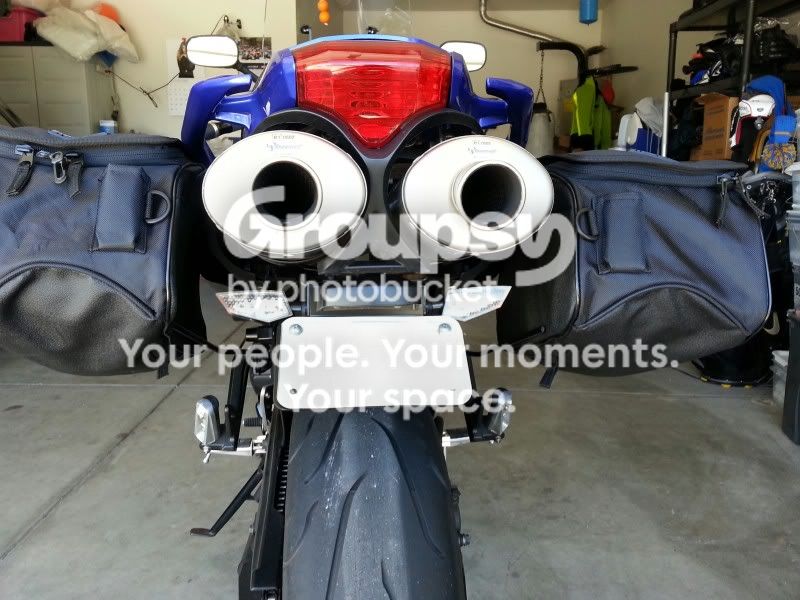

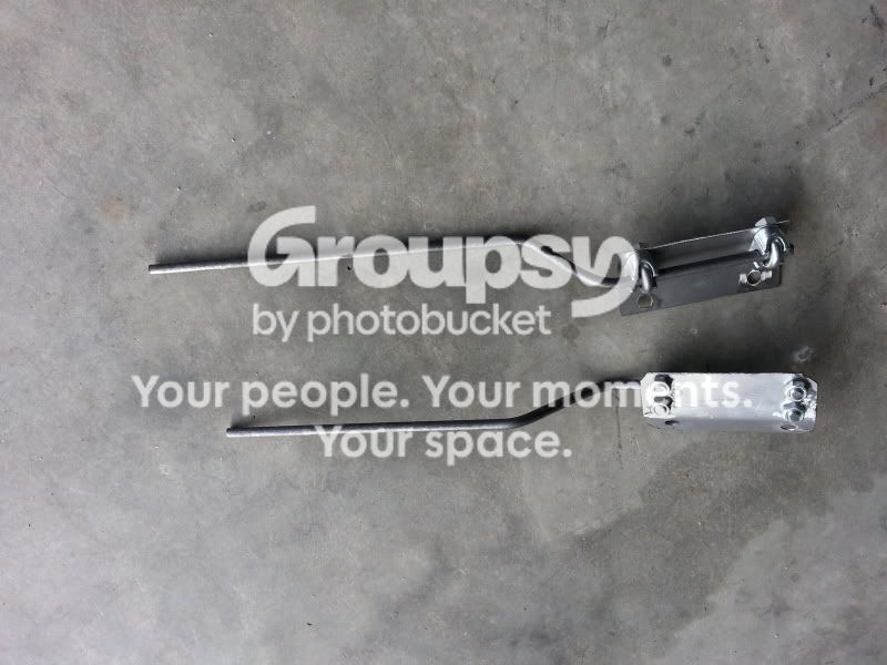

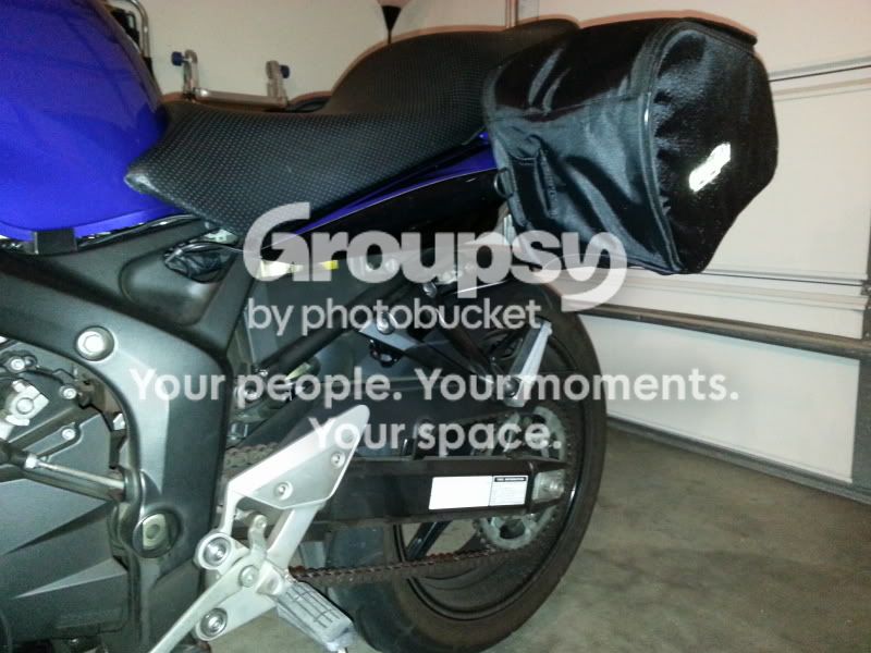

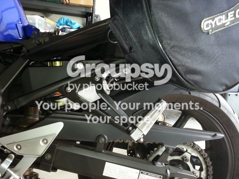

Basing off the Motech Blaze saddlebag brace system, I decided to fabricate my own. I took a piece of scrap aluminum and drilled the holes to mount underneath the passenger footpegs. I then drilled the holes to hold the steel rod.
The steel rod is held in place by two u-clamps. They're commonly used on exhaust joints. I found the little ones at Lowes in the area where they cut rope/chain by the foot.
I then cut and bent the plates so they'd fit under the passenger pegs given that there's a little curve to it. I then double bent the steel rod by hand using a bench top vise and cut them to length. Finally they were painted and voila!
This was all accomplished with a handheld drill and an angle grinder with a cutting wheel and a grinding wheel. It could be done easier with welding which would eliminate the need for the u brackets. In total took me about 3 hours not counting painting.
