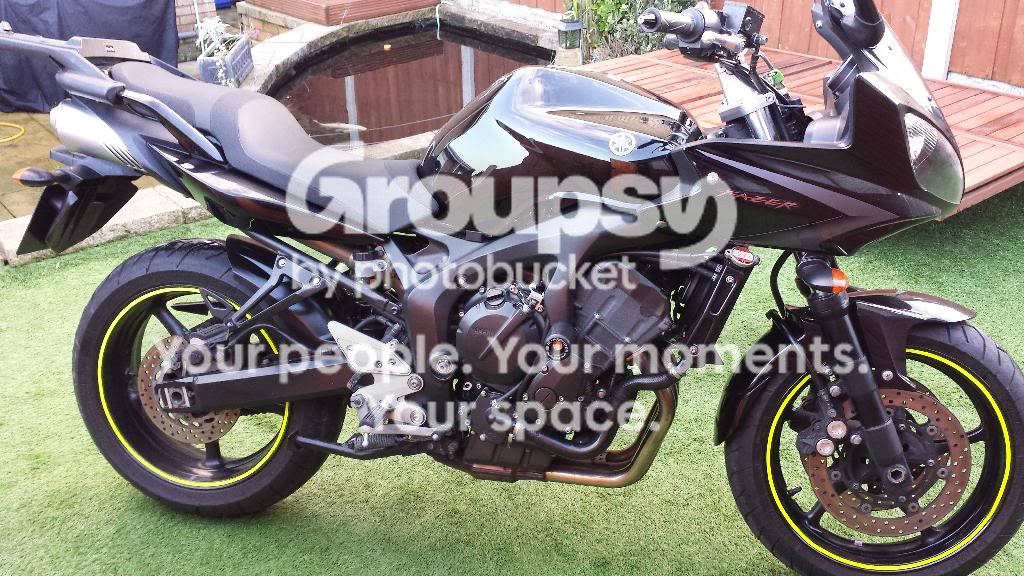

I've been meaning to attack the bike for a few weeks now, so once the decent weather returns, I can actually ride it! MOT booked for Monday so a couple of jobs to sort for that... Safe to say I am now knackered!

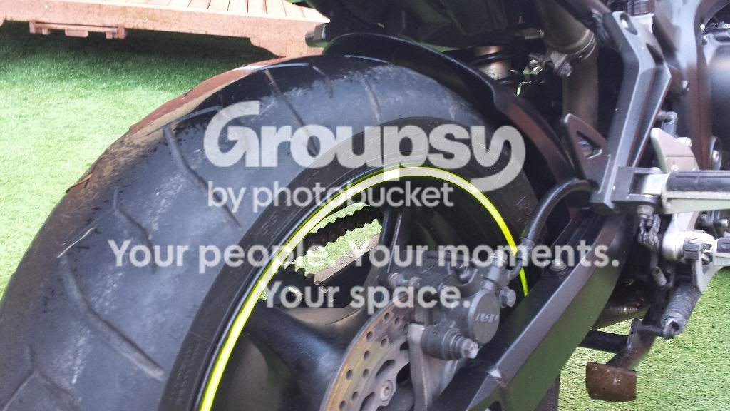

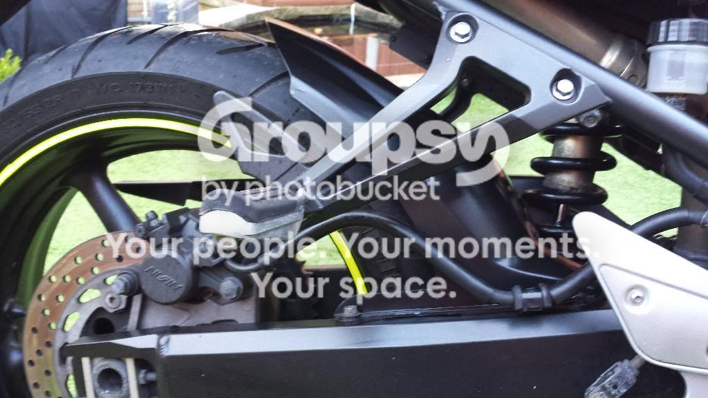

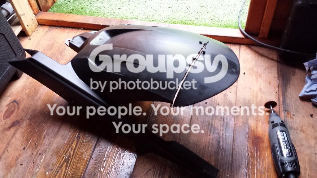

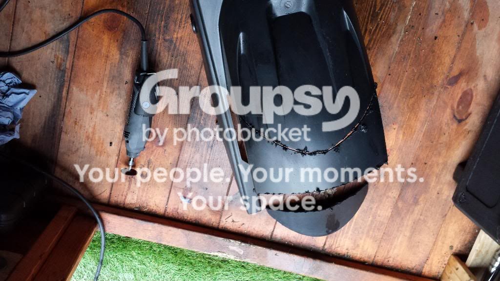

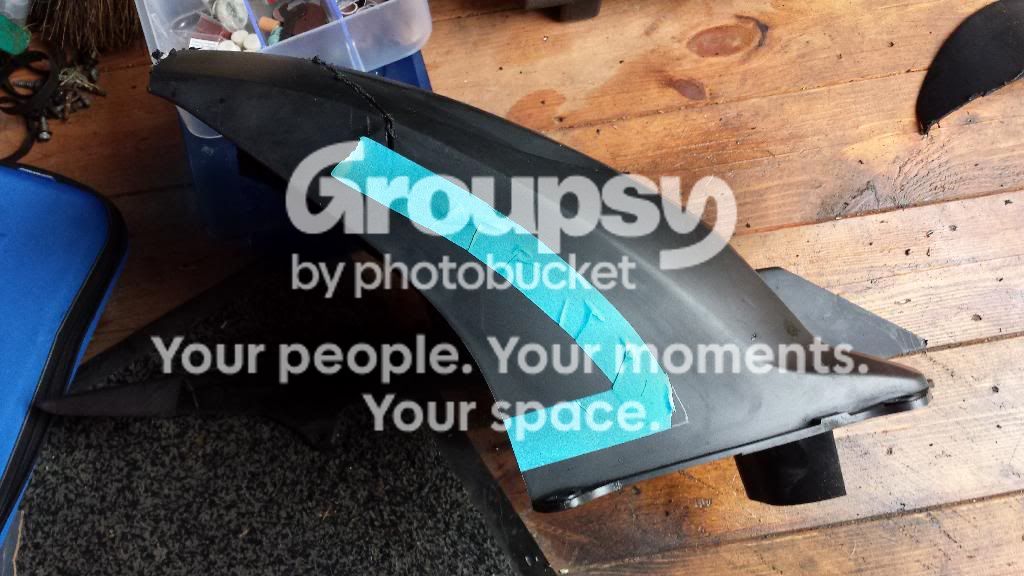

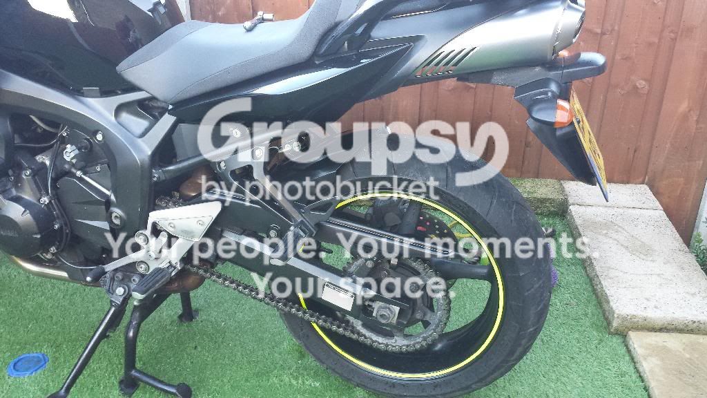

1 - Shortened rear hugger, primed, painted and lacquered - I managed to remove quite a bit of plastic to get more of the wheel in view, the structure is still very sturdy, I think I could have removed a bit more if required.

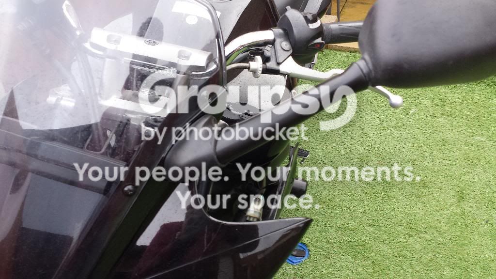

2 - Mirror stalks - took back to the aluminum, primed, painted and lacquered. I painted these with black gloss then used a rattle can lacquer to give a semi opaque finish.

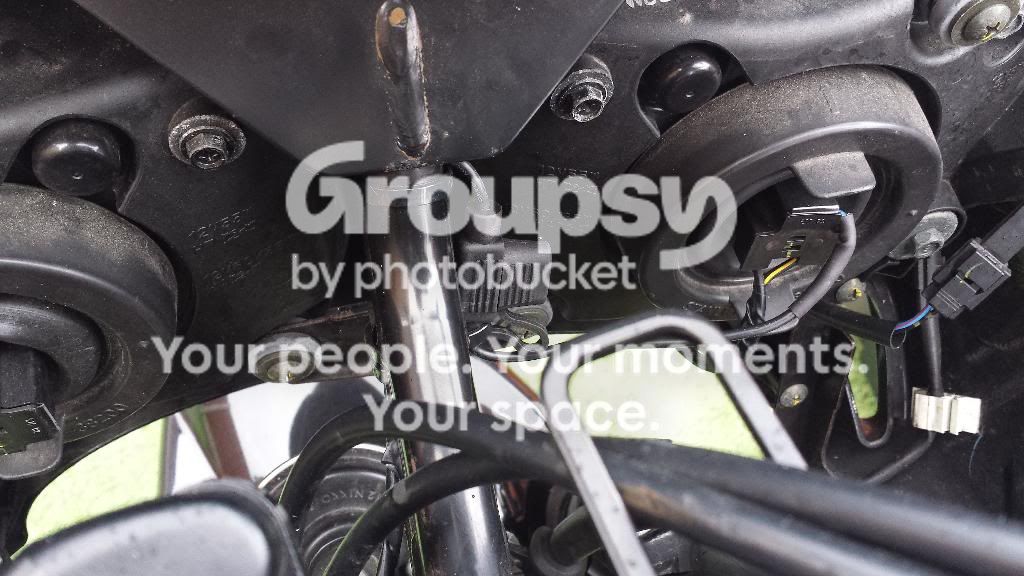

4 - Inserted a waterproof fuse holder for the 2nd low beam (for the MOT)

Next job will be to remove the rear reflector, cut down the number plate holder and refit another reflector somewhere legal and more subtle. Remove and repaint the centre stand, unsure whether to refit. Spray the heel guards and heavily lacquer (or replace with a carbon item). Watch this space.

Joe, it's just a cheapo gloss black - I normally buy half decent tins but the local motor factors only had this. The mirrors took about 4 coats to get even, the hugger was more like 8! you can defo see the quality difference in coverage over decent stuff. The lacquer sprayed gives it a dull finish. I was well chuffed with the mirror lacquer, flawless finish! I think it's a balance of not too much or too little to get that perfect end result.

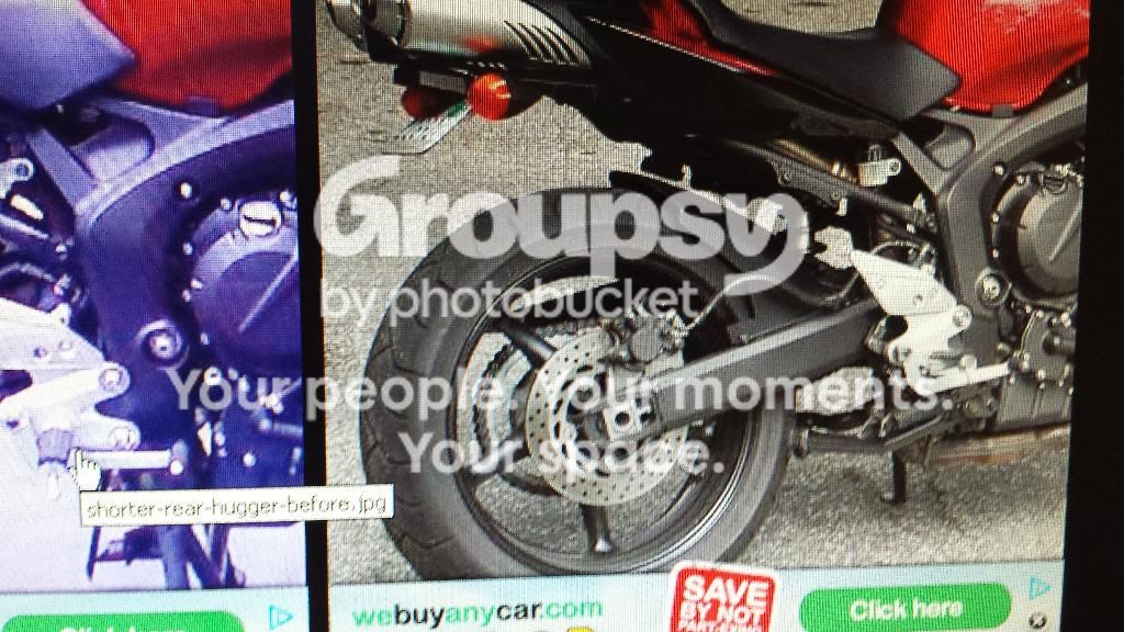

This was my inspiration for the hugger after viewing loads of examples. I can't remember which forum member it was off here.
