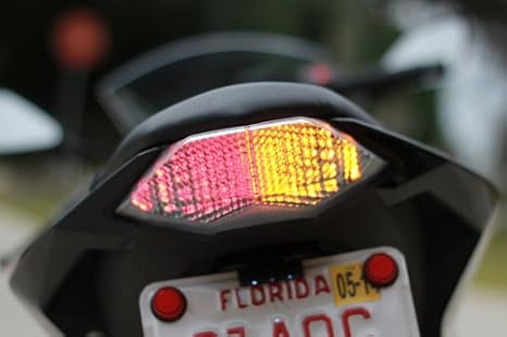

The rear indicator is actually part of the rear light! It's an LED light that is red when riding and brighter red when braking, and when the indicator is turned on, 1/3 of either the right/left side of the light flashes yellow. Pretty similar to this one It's not reaaaaally street legal, but it just looks so sweet :-)
