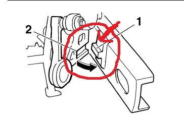

One thing on re-installing the rear wheel, is to pay attention to the rear brake bracket:

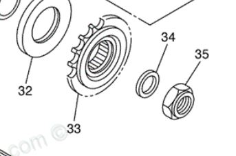

Guys, I don't see the locking tab that goes under the nut that's holding his front sprocket, is he missing one or the earlier models didn't have them?
Random picture from the internet so twobob can understand what I'm talking about;

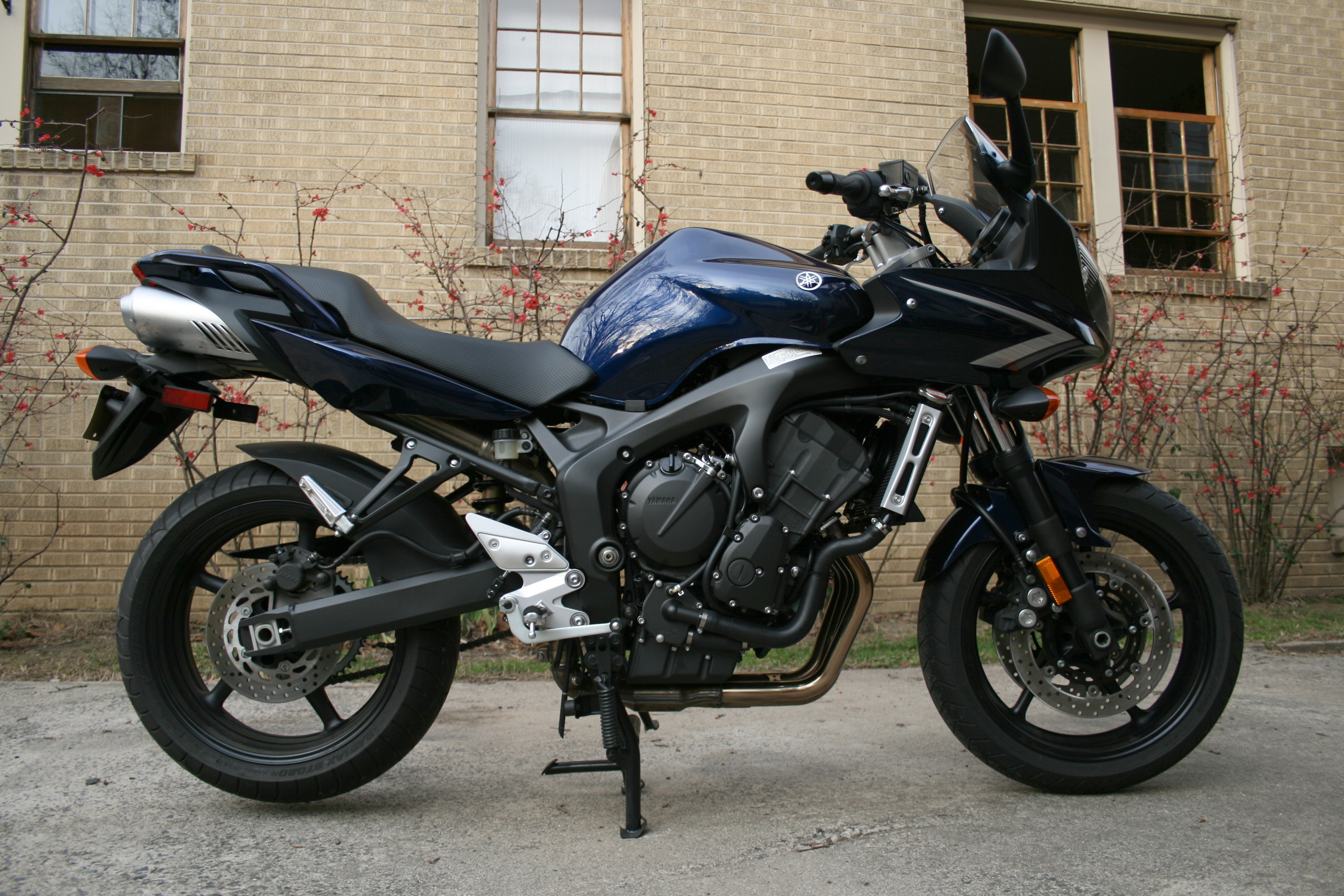

OP, what year is your bike? I see that the frame is silver. In the USA that means it's an S1, but being that you're in Europe I don't know what frames were used.
12,532
1,178
Just an FYI, in many places across the pond, the YEAR the bike was sold (could be sold in say 2011), it's considered a 2011 model.
Even if it was manufactured in say 2005...

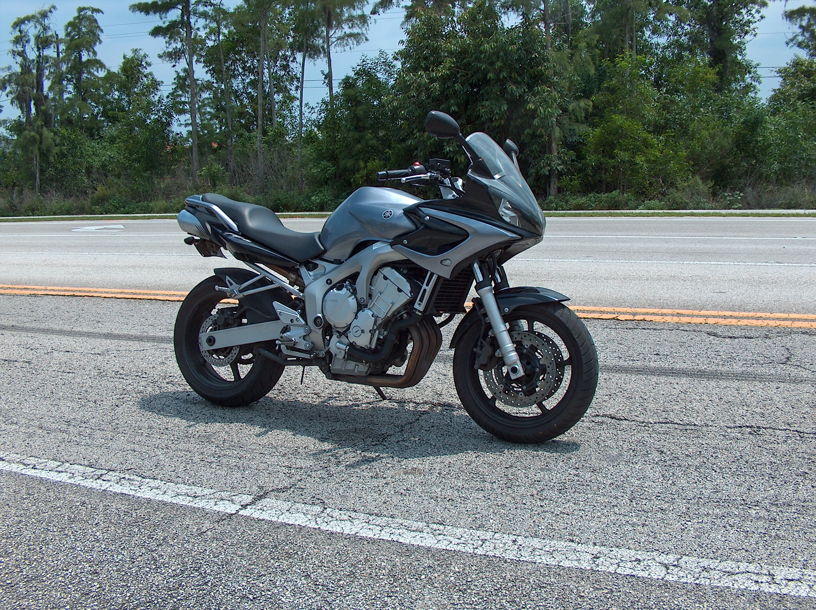

The year of manufacture should determine whether the bike is S1 2004-2006 or S2 2007 to 2009. Although some countries list the year of the bike as the year it was registered the year of manufacture, S1 or S2 should be used to order parts. There are easy ways to tell S1 from S2 but some people change the swing arm from an S1 to an S2 so you need to look at other clues.
Here is a link to help with S1/S2 Identification: https://en.wikipedia.org/wiki/Yamaha_FZ6
S1
S2

I ordered the nut with the foldable tab I believe, my bike id definitely a 09 Made in 09. Although it has a silver frame they did orange and blue that year with silver frame. Have ordered the new nut already with new chain and sprockets. Don't feel overly confident about it but will try my best. My worry is rear wheel alignment and chain alignment also weather I have crimped the chain properly and also that nut..... thats a lot of stuff that can go wrong.

The biggest thing to watch for is that the brake bracket (I posted a pic earlier in this thread), is in the slot.
