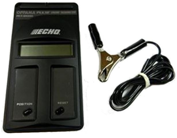

They make cheap, very small tachometers that the wire wraps around a spark plug wire.
Their fairly accurate and will take the guess work out of your situation..
A higher end electronic tach I use for mostly small engines:
