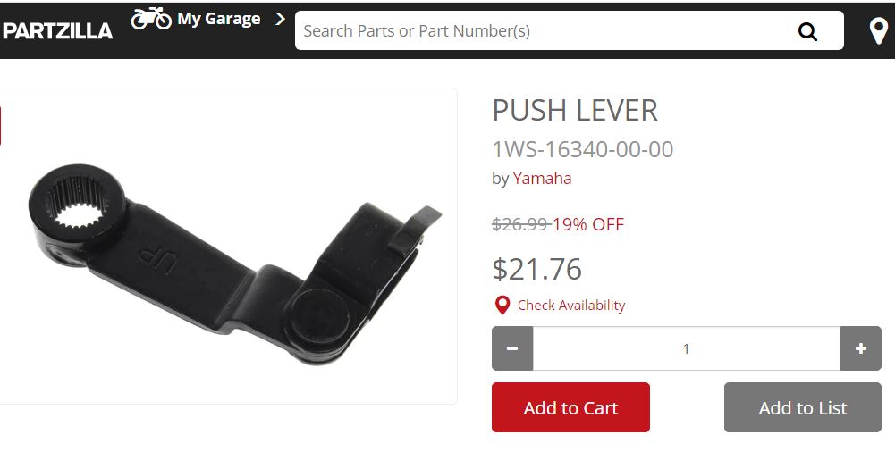

An easy mod which widens the engagement zone and makes the lever pull noticeably
easier is to replace the engine pull lever with Yamaha part # 1WS-16340-00.
It's slightly longer (more leverage/control) .
With the above maintenance and mod, it'll shift smoother and less jerkiness.. It can easily
loosen the pull up to approx (IME) up to 40%.
More control of the clutch will help. I also keep my idle at about 1050 which also seems to help
(smoother idle, lower RPMs to lessen the jerkiness)
*I find the cable itself likes to "gum up" in the curve just above the engine...*
Part # 25:
