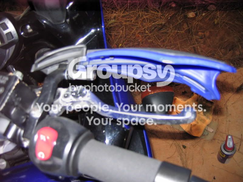

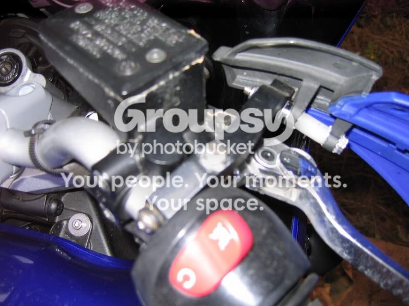

if someone else doesn't beat me to it i'll see if i can get some quick pics up tomorrow. in short, using the mounts i used i had to move the clutch and brake levers. the mounts go between the grips and the levers. does that answer your question?
dean owens
Hippopotomonstrosesquiped
Apr 6, 2009
1,318
pittsboro, nc (near raleigh)
www.ccf-unc.org
1/4 inch ? maybe. i noticed it when i first did it simply because it was a change. but a quick ride and i was already used to it.
i only have two issues that i just have to deal with.
1 - my clutch lever slightly touches my left handguard. makes me wish i had some of those high dollar levers. i've thought about just cutting off the ball on the end of the lever, but i'm pretty sure it's a safety feature. so i think i'll just leave it alone.
2 - keep in mind for this one that i have an '06 with up/back risers... when my bars are turned to their max they will hit the windshield. i NEVER have to deal with this except for when i back up each morning and turn my bars their max. otherwise it never happens. i've never even had it happen when i do u-turns. maybe i'm not doing them correctly, but they've never hit except for at their absolute max and that's when i back up.
i'll try and take a quick pic of these two issues as well.

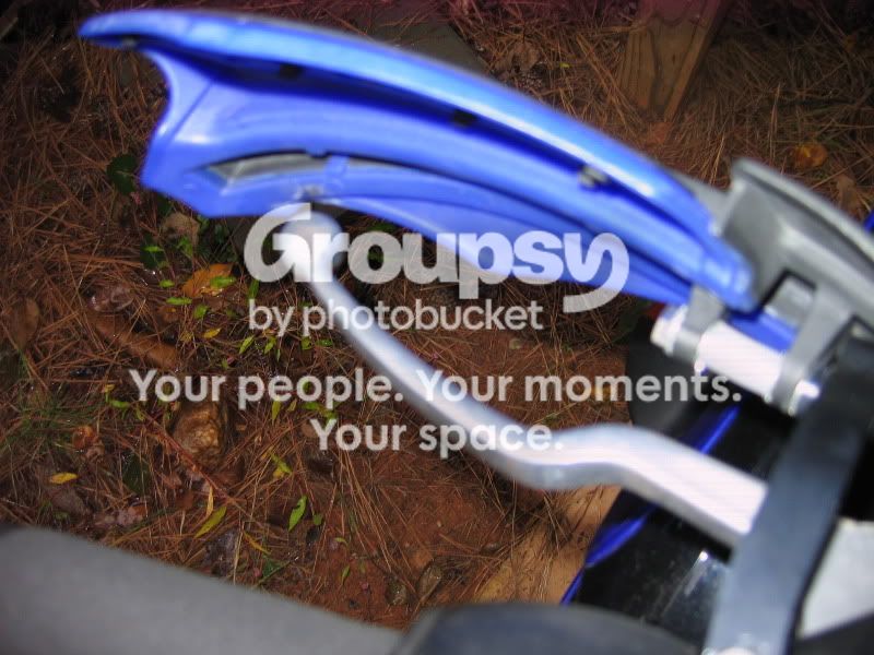

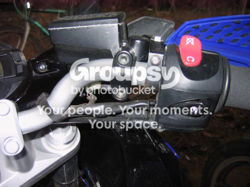

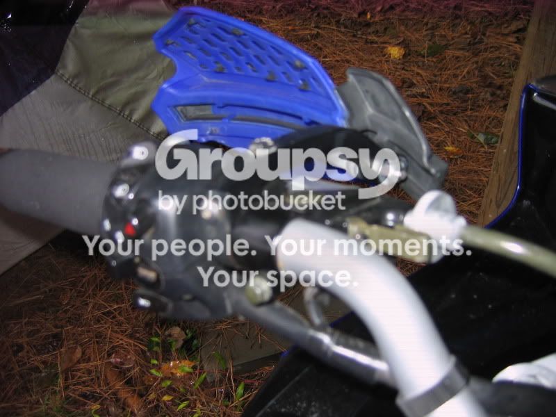

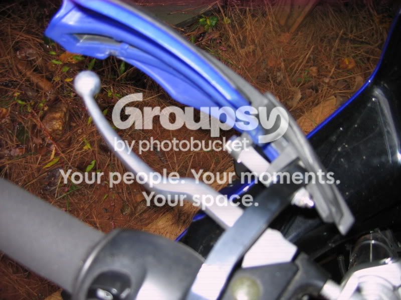

according to the diagram discgolddude posted, i have mine on upside down. when i first got them i actually tried to install them that way but couldn't get them on because of the cables that come out of the controls. i might try and give it another go some time soon.
also, these pictures are horrible. but hopefully they give you an idea of what i was saying.
in this one you can see that my clutch lever isn't touching but that's because my clutch lever never fully "expands". you can see the little gap at the hinge.
this is fully extended. it would hit but that screw got bent when i dropped my bike at a camp ground (stinkin' uneven dirt). i've used the bend to my advantage so it no longer hits. but you can see where it would hit (and did hit before the screw was bent).
brake lever has no issues.
and here it is fully locked and hitting the screen. as i said, not a big deal. only turn my bars this far when i'm backing out in the morning.
hope that helps.
