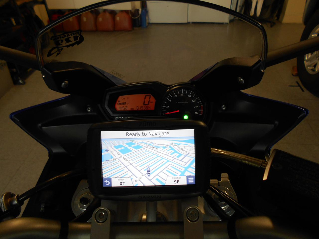

The mirrors, headlights and tail lights are different. You can make the S2 instrument cluster work on the S1...but it’s not plug and play. Do a search and you’ll see the wires that need to be de-pinned and re-pinned.
If you have an S2 to part out, you may be able to swap for the parts you need, or at least sell the S2 parts to pay for the S1 parts you need. The swing arms are different, but the S2 swing arm does fit the S1. There’s no performance benefit, but it does look a lot better.

I need to correct myself. If you have an S2 instrument cluster, WITH an S2 forward harness, the swap of the S2 instrument cluster to an S1 IS plug-n-play.
