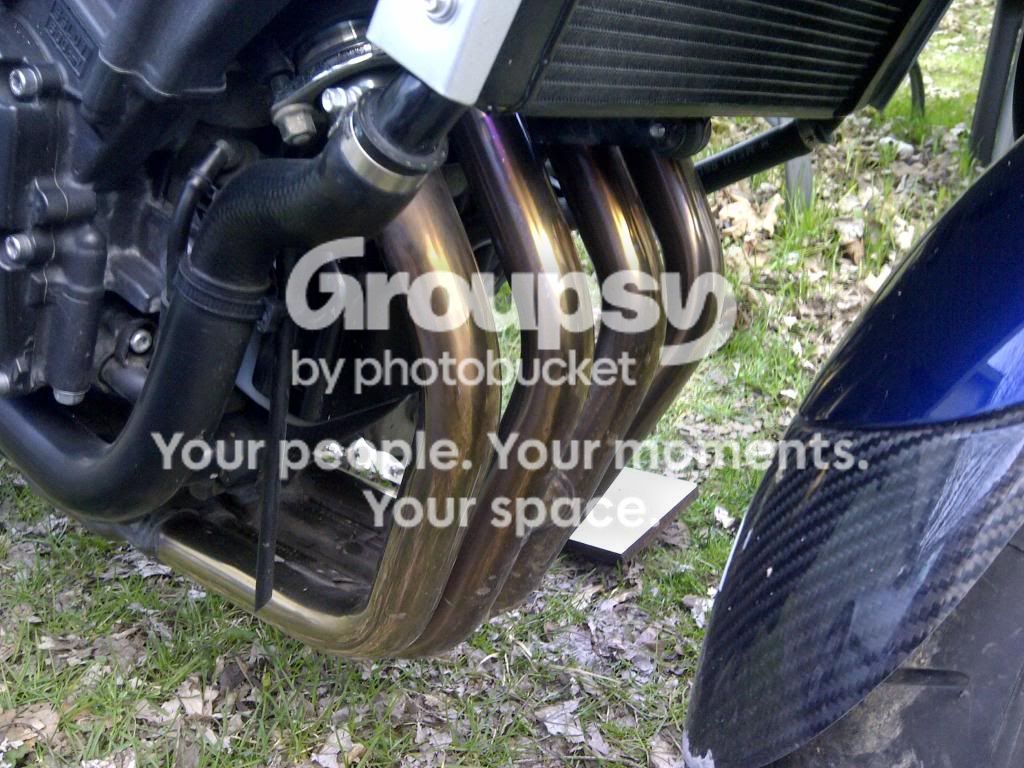

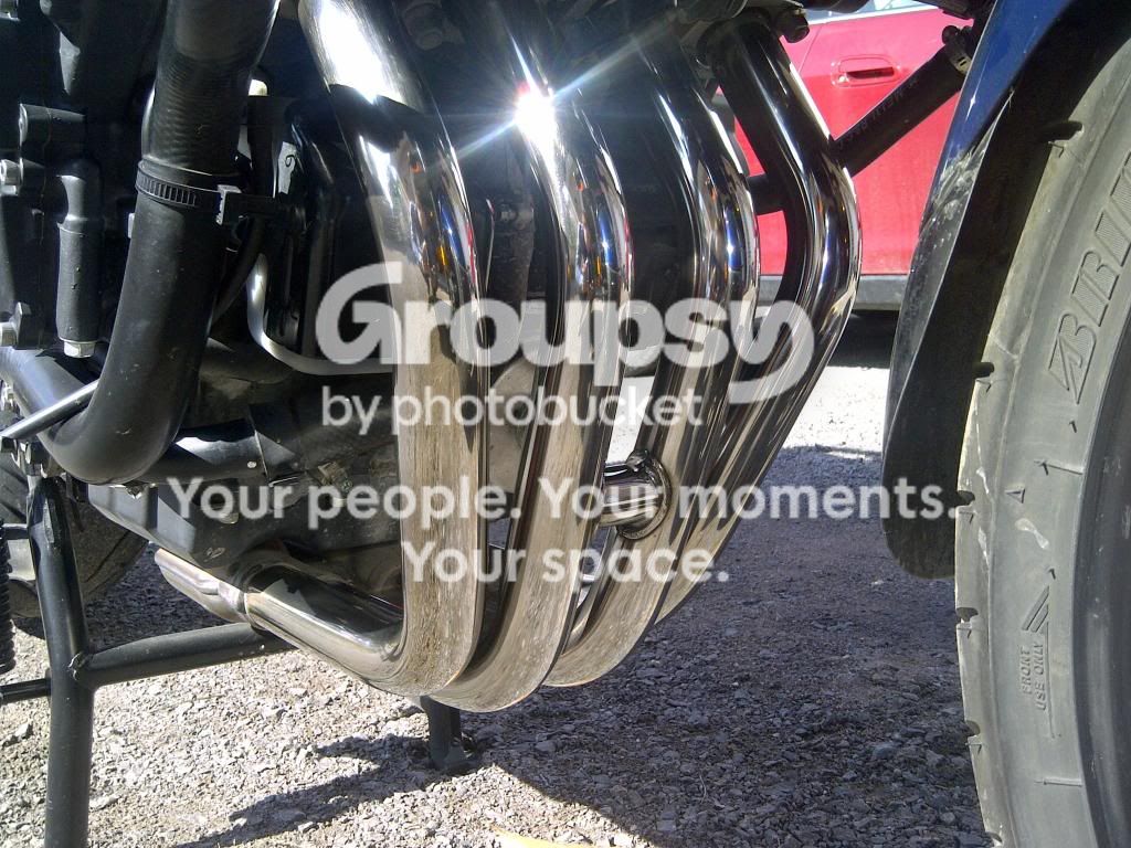

Here's what I managed to accomplish with them on the bike:
Before:
After:

holy crap, nice work!
you did all of that without any wet sanding? in that case, maybe I will keep them on the bike and do the sawing back and forth motion like you mentioned... and ya, I won't deny it, I'll like put a sheet over the rest of the bike and then use mothers powerball haha! gotta try it at least!

LOL The powerball is the exact thing I tried, it actually seemed to take longer, I think cause I couldn't put as much pressure on it as I could with wrapping a cloth around, I could actually feel the cloth and header heating up a bit from the friction I was causing when I was sawing on them really fast. The powerball also doesn't get in-between or behind the headers and was always hitting my front fender.
The after pic was with some wet sanding, but it was a 2000 grit and I probably spent 5 minutes total with it, really only used for the really tough little water spots.
