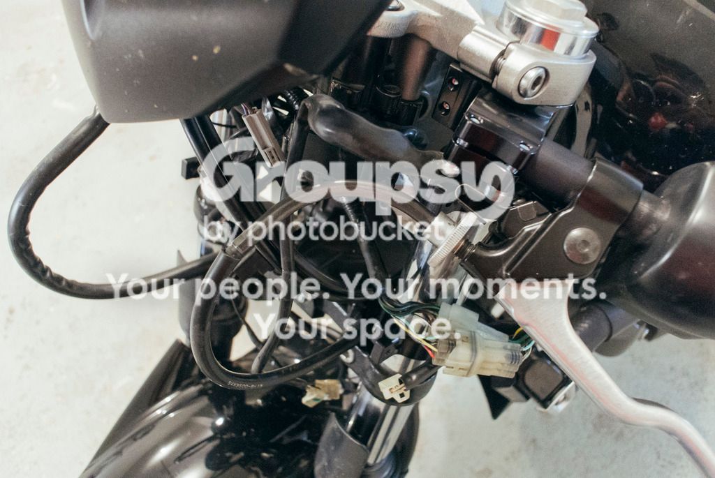

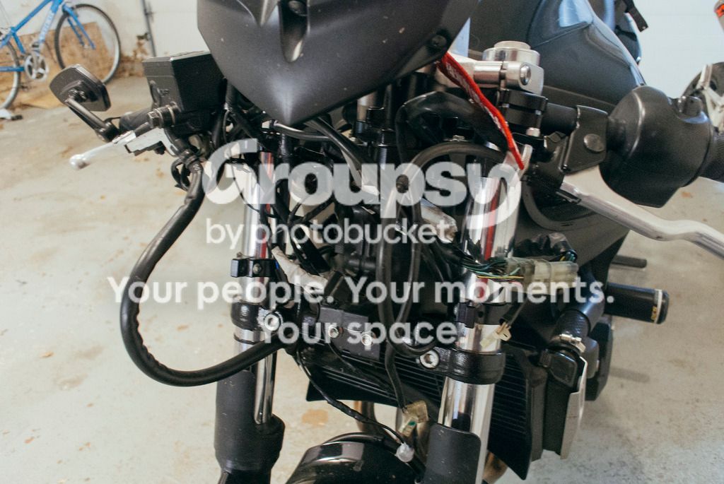

Worked on mocking up the clip ons a bit more yesterday. I think I've made a list of issues that I will need to solve.
  1. Relocate Turn Signals
  2. Reduce Length of Brake and Clutch lines

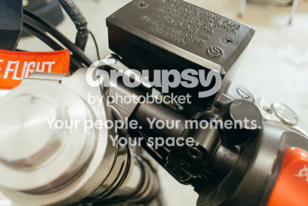

  3. Master Cylinder/Reservoir Doesn't Clear Clip On Bracket
  4. Adjust Steering Stops
The turn signals simply don't work in their current position. They will have to get moved, maybe just moving them lower will work. The clutch and brake lines are a little more concerning, the clutch is OKAY and the brake lines are OKAY. However, with my naked headlight conversion there just really isn't room for the extra cable and hydraulic lines. I will have to either shorten them or deal with them hanging out somewhere. The master cylinder/reservoir combo is my biggest issue. The reservoir part doesn't clear the clamp for the clip ons. The clearances is only a couple of millimeters to small, I suppose with a different brand of clip ons this would have been a non-issue. Perhaps I can switch to an R6 master cylinder? Steering stops should be somewhat straight forward. I'm thinking I can drill a couple of holes in the lower triple clamp and just drop some bolts through them.
Thoughts?

I just gave a Ninja 250 back to the owner after doing some work on it. It also had clip ons ( BUT atop the upper triple-forks slid up).
The turning radius was easily 1/2 of normal before controls, etc starting hitting the tank, fairing, etc...
*Point, you may try moving the throttle, brake/clutch, switches over to the clip ons before going further. You may very well have the same issue.
The Ninja could NOT turn around in a two lane street W/O doing a three point turn... :(

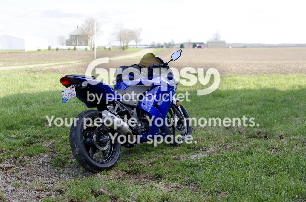

I don't know... before the FZ6 I had this....
It was pretty much the least reliable piece of equipment I have ever owned.
I bought it new and from day one it was a temperamental thing.
The bike would start and run just fine, but probably 1 out of 5 times I would park it it wouldn't start back up.
If it was parked long enough to cool off completely it would start no problem, but 1 out of 5 times it wouldn't start warm.
I had it into the dealer probably 10 times complaining, every time I was told nothing is wrong with it.
I finally cut my losses and sold it and picked up the FZ6.

I unfortunately can't take it for a spin with the clip-ons until I figure out the master cylinder reservoir issue that I'm having. Also, I'm not going to leave them on there until I can do something about the length of the clutch cable and brake lines.
The important bit is I got everything measured up and I made a list of what I need to do, so I'll be able to get this accomplished once the snow starts falling.
