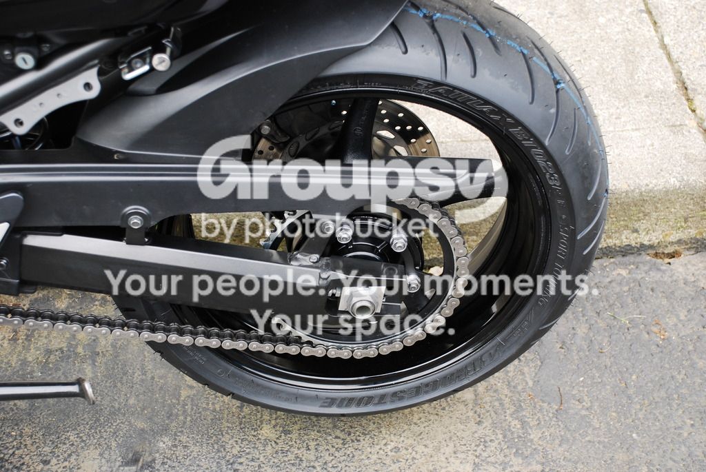

Sunstar PN: 2-547448 48-Teeth (530 PN) for the rear if you want to go that route. Hint: Amazoo for $42 so it cost more, but the chain doesn't have to turn as sharp of corner....
It's steel and lighter than the OEM 46T Sunstar from where they trimmed the material. A worthwhile change and the stock chain will fit but it does move the axle forward 3/8"
That said you get more ratio change w/ 15/46 - 3.07:1 vs 16/48 - 3.00:1 but its so close, who cares...
If you look close you see its cut out right to the edge near the teeth.
It does not come in black - that's powder coated.
Yes, the rear sprocket swap costs more, but here you can see the difference in material removed making the sprocket a lot lighter.
Sunstar PN: 2-547448 48-Teeth vs OEM 46 tooth. Notice the material being trimmed right up to the teeth, the beveled teeth, and the narrower spokes. Its a lot lighter.
