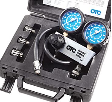

While you have the valve cover off, checking clearances, do a "LEAK DOWN TEST". (Much easier with the valve cover off).. You'll need a small compressor (100PSI) and the tool.
If your not familiar with it, to do the leak down test you bring that ONE cylinder to TDC (compression stroke) and lock up the crankshaft(right side).
Hook up the tool into that cylinder and pump in 100 PSI. If a valve is bent, it will show a low reading on the tool and you'll hear air coming out either the exhaust or intake.
A leak at the intake would indicate a bent intake valve, same for the exhaust. You will know EXACTLY what valves are bent.

This is the tool I use, about $60.00:

I know a leak down test would probably be the best thing to do, but I'm trying to hold off on that as a pancake compressor and a leak down tester would set me back around $170.

Being that deep and the bikes still apart, it won't take your guy 1/2 hour to check with the Leak Down tester. That tool has saved me a bunch of time trying to get an engine running right..

I went ahead and bit the bullet, got the leak down tester you suggested and a pancake compressor. Valves are perfect!!! 1-2% leakage on all of them, measured each one three times just to make sure.
