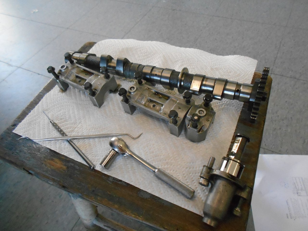

When I did mine at 26,600 miles I had one exhaust valve that out of spec's by .001"-
Now, pull the cam, chain, etc for .001"?? (#4 exhaust too tight).
I already had a shim kit and heck, that's why they have spec's. Out she came. Took a bit longer
but I know she's good for another 26,600 miles.
Yours, not knowing if it's ever been done, ever, is a definite "at least check it"
BTW, most first checks (from reading here the last 10 years), don't need adjustment. A few have been loose as well..
From 1-6-19, my exhaust cam pulled for adjustment:
Lastly, should you pull both cams, mixing them up is EASY. There is a way to tell the difference (I forgot but do a search here if need be)...
