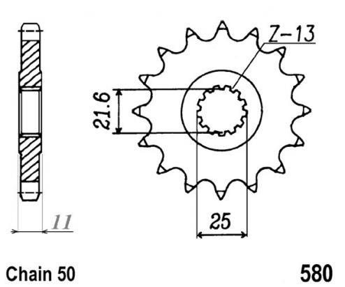

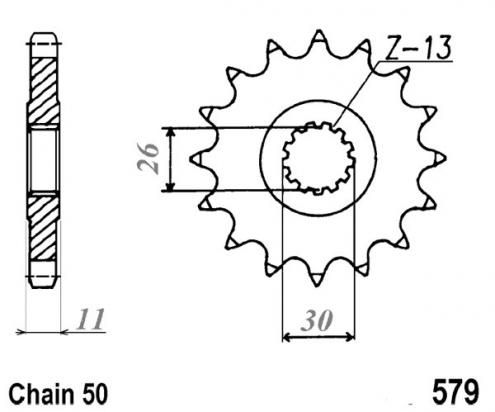

FZ1 has 17T front sprocket but looking at the dimensions the center hole is different.
