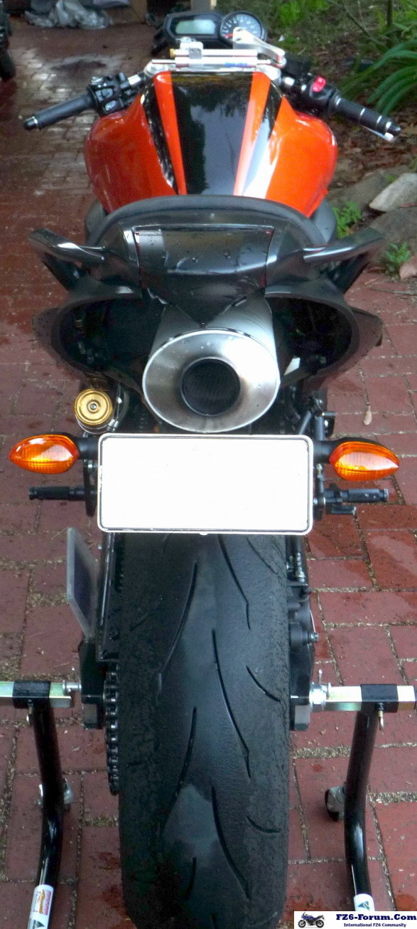

Single Pipe, with modified seat under seat area, and Exhaust surround
Had to cut the vertical piece of plastic that runs between OEM exhaust end pipes.
Used an R&G fender eliminatoir to mount number plate....R&G fender eliminator bolts straight onto OEM rear fender mount. Ran indicator wiring along this mount.
FZ6 Single exhaust mod!
