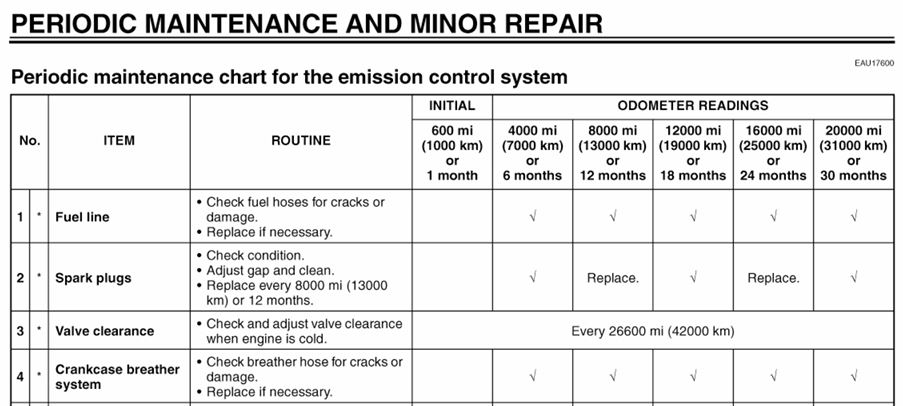

Do you know if the 24k mile valve clearance check was done? The next one would be at 48k, but if you're not sure, it may be worth having a look (although it's a bit of PITA to do!)
