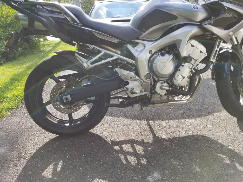

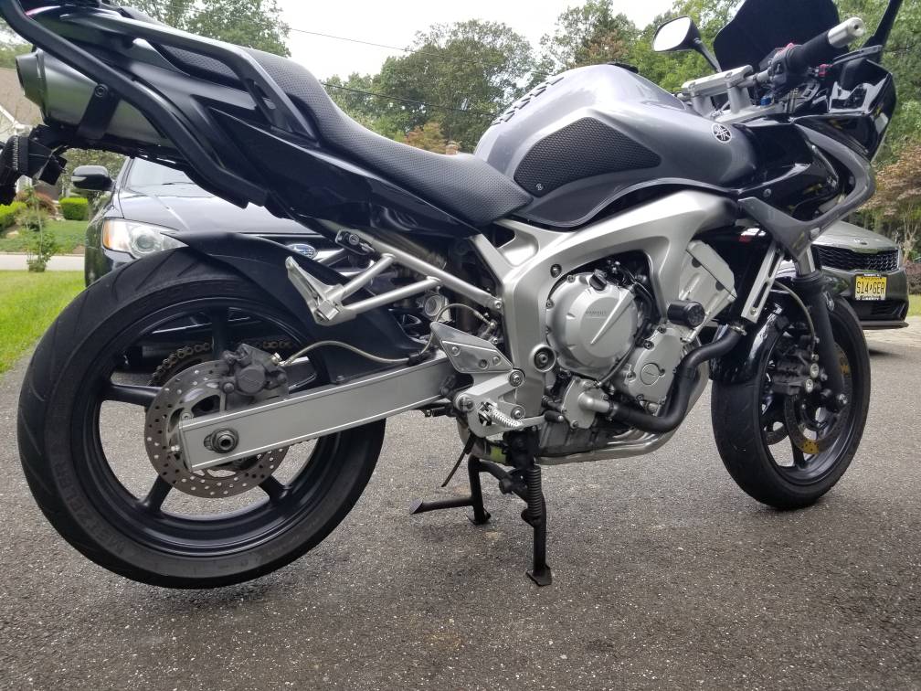

Installed an S2 swingarm on my 05.
Thanks [MENTION=25322]I JET[/MENTION]
Sent from my SM-G950U using Tapatalk

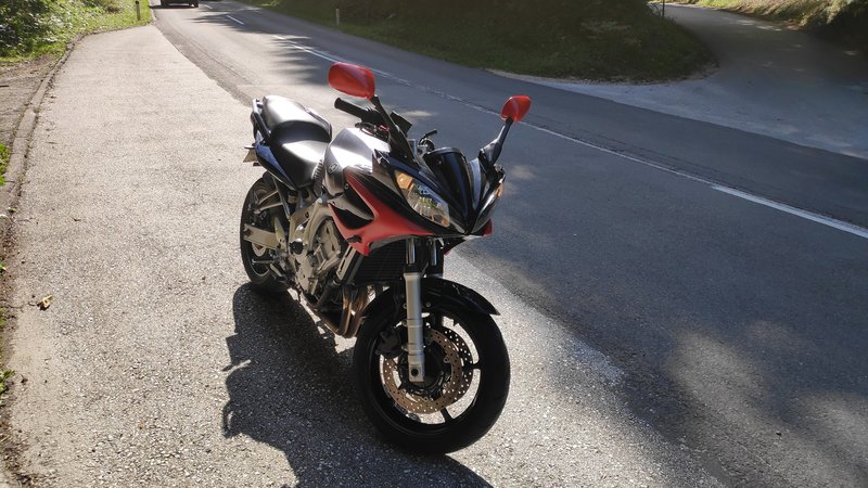

gnyce
Nov 29, 2015
338
195
43
north of Philadelphia PA, US
All new plastics! (Givi) windscreen, slightly taller, plus all new bits around instrument cluster. I know some prefer going naked - I will admit, it didn't look half bad with everything off - but I take my FZ6 on long trips cross-country, and prefer the wind protection. PO had previous broken some of it with a drop, and then I added to that with a ditch encounter last winter. Took advantage of the Christmas break to install. She looks new and happy (and ready to break 50,000 miles)!
