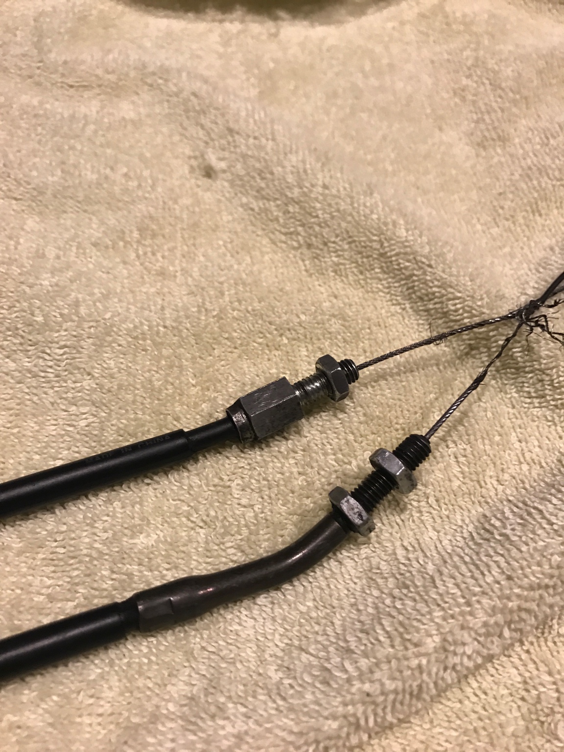

Old thread, but thought this was an appropriate place to post.
While changing my thermostat over Christmas, happened to notice some fraying on the "pull" throttle cable. Yikes! I've always kept throttle/clutch cables lubed, but for whatever reason haven't inspected the throttle cables where they attach at the throttle bodies in a long time. I ordered both cables, why not replace the "push" cable at the same time. They are both almost 12 years old, and only $10/each from Partzilla.
No real issues during the replacement, pretty straightforward. Turns out I had issues on both cables. But WOW, I came pretty close to snapping the main and stranding myself somehwere! Little word of advice, take a peak from the side with a flashlight and examine your throttle cables for any fraying!

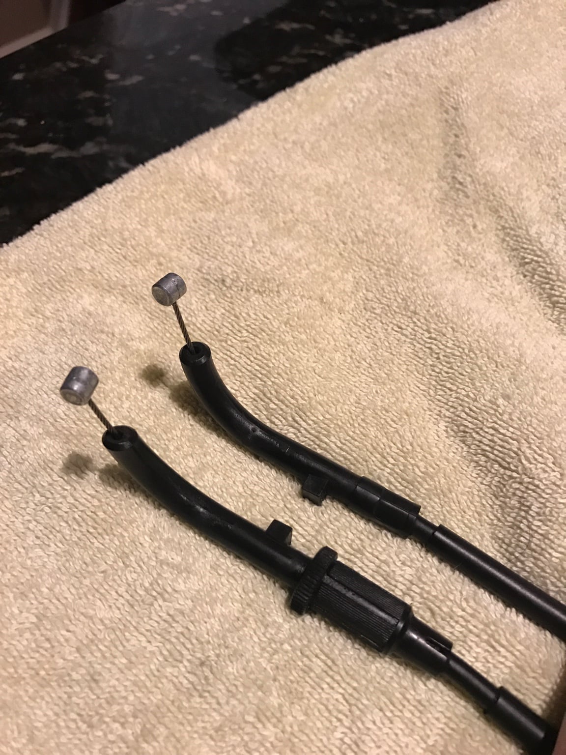

Abstract - lets say you broke the main pull cable used to open the throttle. Is there any chance a stranded rider could "rig" the return cable **in place of the main cable** and ride home?
Likely using the carry on tools in the oem bag.
Perhaps you could take a picture of the two cables side by side? Thanks in advance!

Yep, I know both pull. But for some reason that's how they're referred to.
Bike is a 2005. Just over 36K miles. I don't know the full history of how it was kept, unfortunately. But I do know it was purchased new in the high heat city of Scottsdale, AZ; sold to someone in Delaware 4 years later. Then sold to a buyer in PA, who garaged it full time. I purchased in Jan 2012 and have kept it garaged and even sometimes in my living room. Of those 36K miles, I've put on 26K of them, mostly in commuting, mostly in dry weather.
The two cables are the same length, but have slightly different connections/adjusters for cable tension. I'm thinking you could swap them in a pinch, will have to look closer. It would be tough to get it done roadside, as you really need to remove the airbox to get access. Theoretically, if you have small, long fingers, I guess you could get by without removing it. Will try to take some pics when I get home.
Okay, pics below. You can see the differences. If you wanted to swap them in a pinch, hopefully you would have a knife or pair of side cutters to nip off the plastic tab that sticks out of the side at the handlebar connection end. Other than that, it would fit in my opinion.
Good to know!
Sent from my iPhone using Tapatalk Pro
^^ + 5 for follow up and a Rep point for you!
Knowing this could get someone home!
Thanks man!
