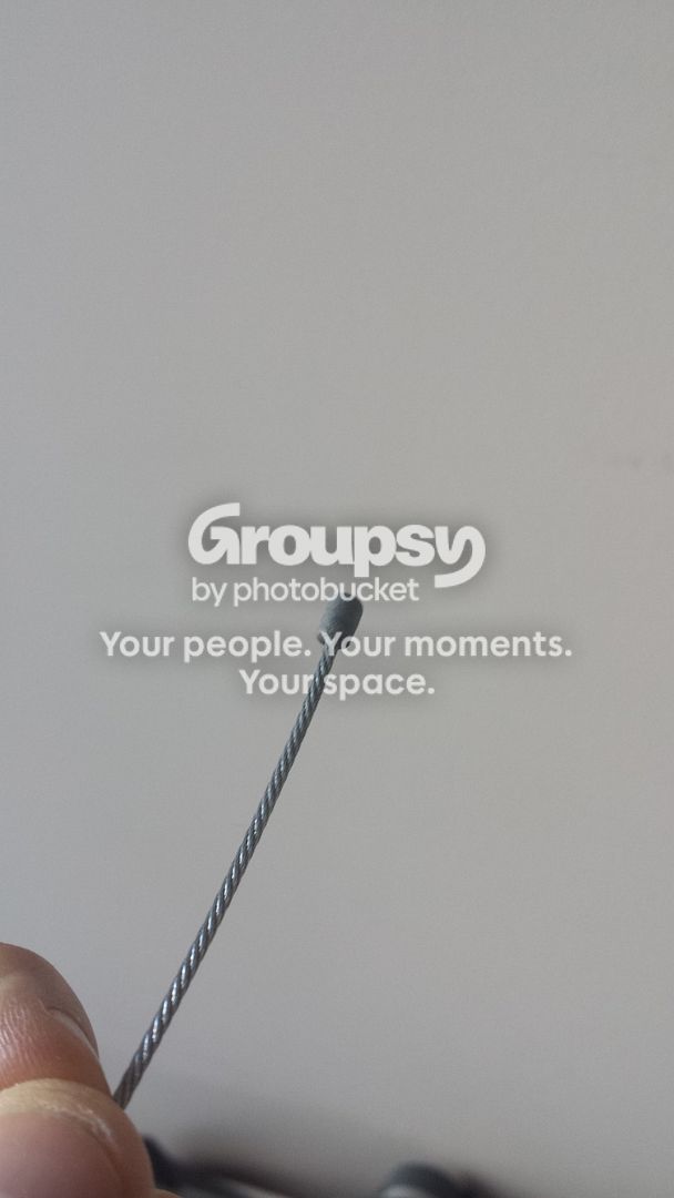

I've had to mod the clutch and front brake cable to be shorter to work with the new bars I've put on, I did this by cutting the old cable end off, shortening it, then soldering on a new end. This worked out well and seemed good. I'm working on the throttle cable now, there are no aftermarket ones and like zero used ones available, so I bought a new one that looked similar from motion pro, it just needed altering. The piece that goes in the carb needs to be a lot smaller than what was on there, and it needed to be shortened a bit. After fiddling around in the garage for quite a while and failing to get anything done I came up with the idea of using JB weld and shaping it to exactly what I needed:
[/URL]
My question is, does anyone think this is a bad idea? I used the high heat variety and I know this stuff gets pretty strong, but I would hate for this to fail and end up getting sucked into my engine. Does anyone else have any other ideas? I tried all morning to drill through a bit of steel so I could solder it on like I did with the others but I dont have a precise enough drill press/kept snapping the bits since the hole has to be so small

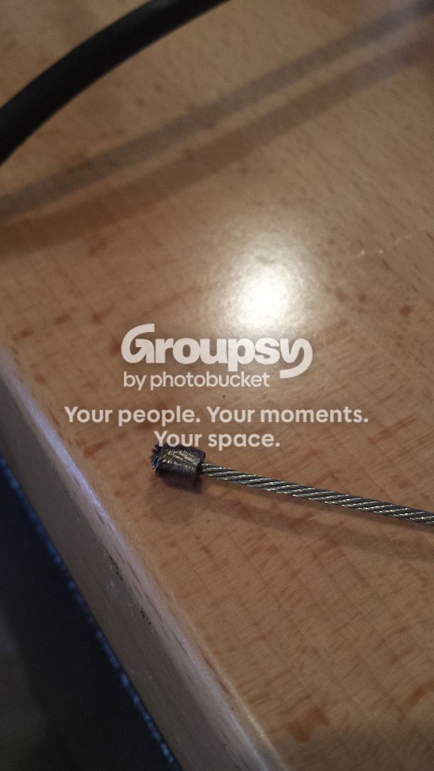

Yeah I decided against the JB weld, while this cable really doesnt take much force (single slide pull only carb) I didn't want to risk it, so I tried some drilling again and ended up with some success

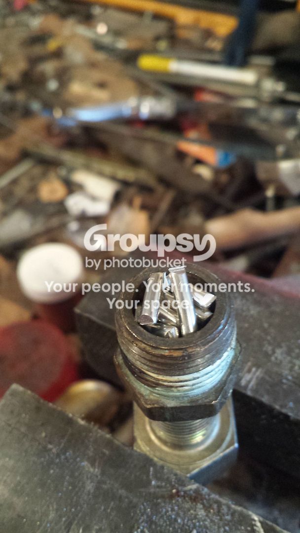

Clean it all up good, dip in flux and slide it on, spread out the cable on the outside to give it a good area to suck in solder

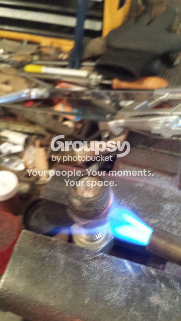

Making a little solder pot:

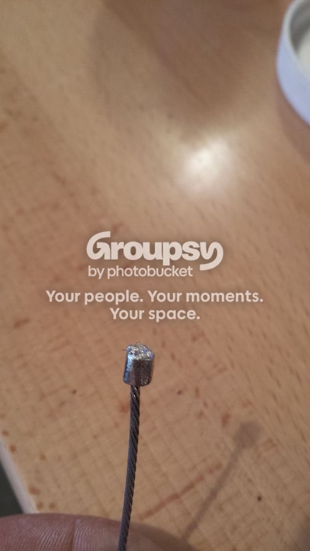

Just needs some grinding and clean up:

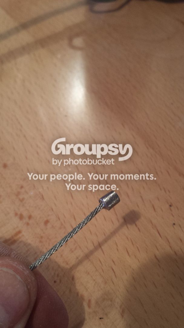

Finished Project:

I would be happy with that. The crimp alone probably could have sufficed, so the solder is just icing on top. :thumbup:
I wish that was a crimp haha, I dont have the tools for that though. That's a bit of round stock I managed to drill a 1/16th hole through, I soldered it on with a bit of an old school method then filed it down to an appropriate shape
12,538
1,185
That final piece should be fine, the solder soaked into the twines of the cable, looks great BTW..
