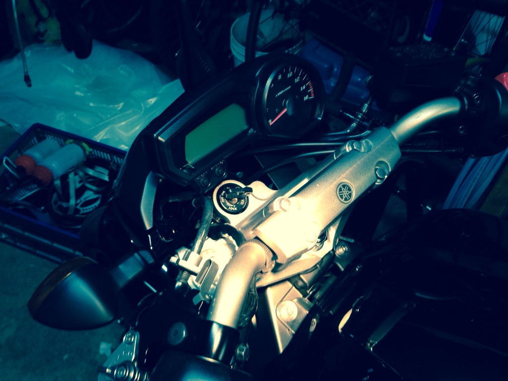

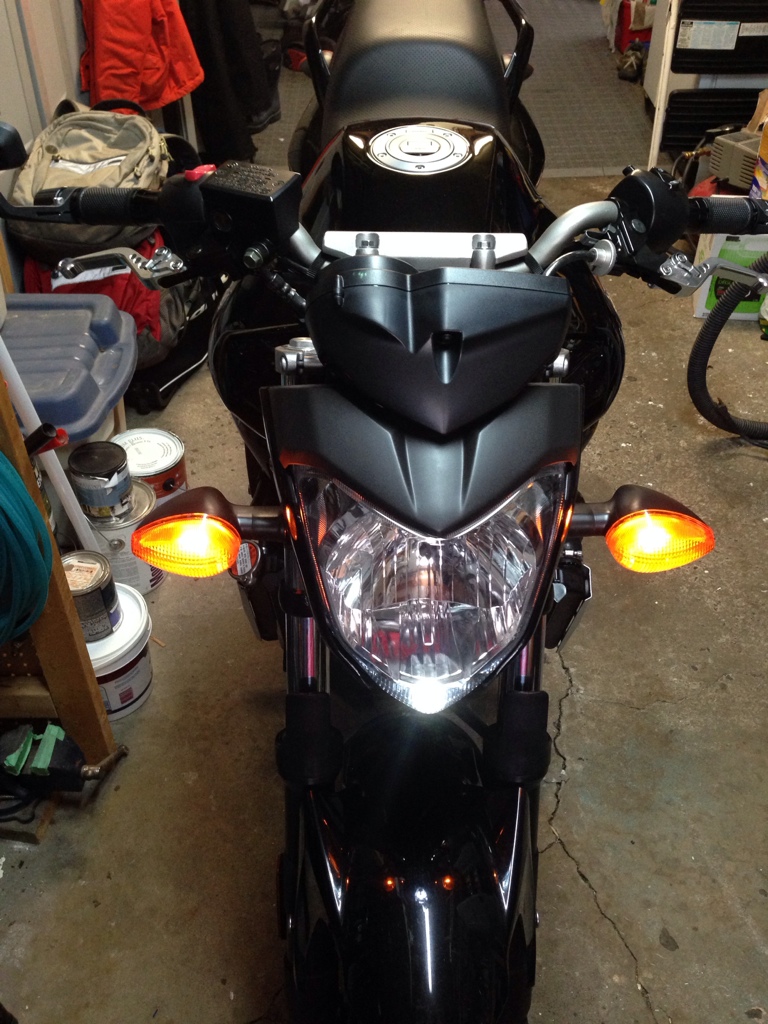

Yeah but I went with Lean69's speedo bracket as opposed to the VS speedo plate, problem solved. Not sure if he's making them anymore.

I think he had some diagrams available. He had passed them onto me to confirm measurements before purchasing. Perhaps ask him? I don't have any pics of it before install and in it's installed state, you really can't see it.
In some of his older posts, you can see it.

Hi. No problems at all with the bracket. Some misc issues with the VS kit but were resolved/tweaked. I had to cut that section of the VS bracket off, so no more fly screen either.
