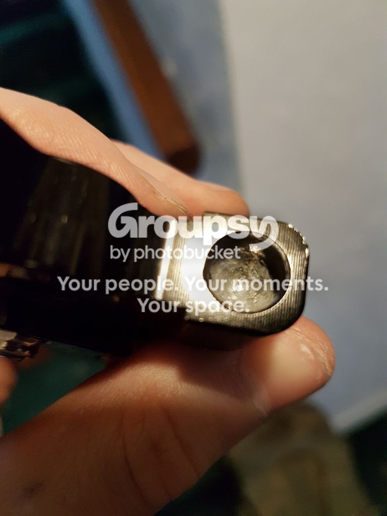

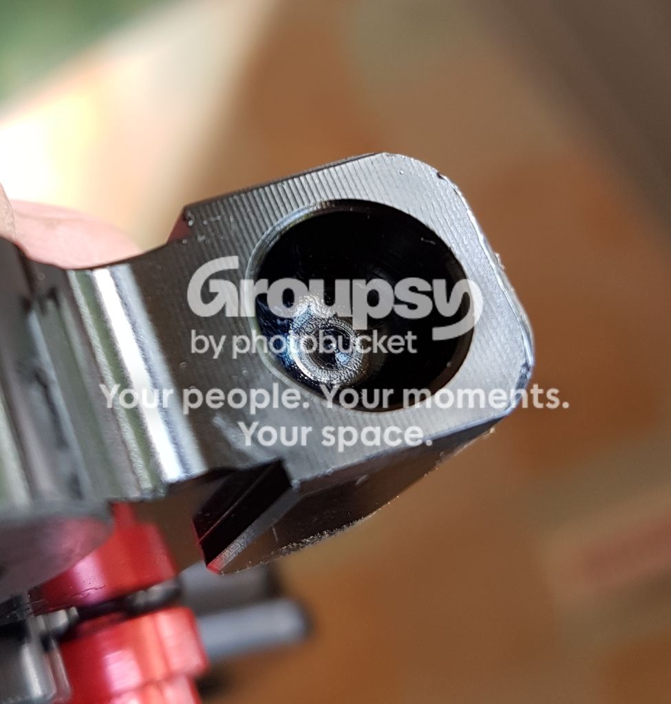

After reading some horror stories about Chinese levers I was skeptical but thought I'd try my luck and see if I could get a decent pair. They came and the quality seemed good and I was fairly impressed. I went to fit them today and the clutch lever went on a treat. The issue I had was with the brake lever; there was a little dimple protruding outwards in the master cylinder pin recess due to bad machining.

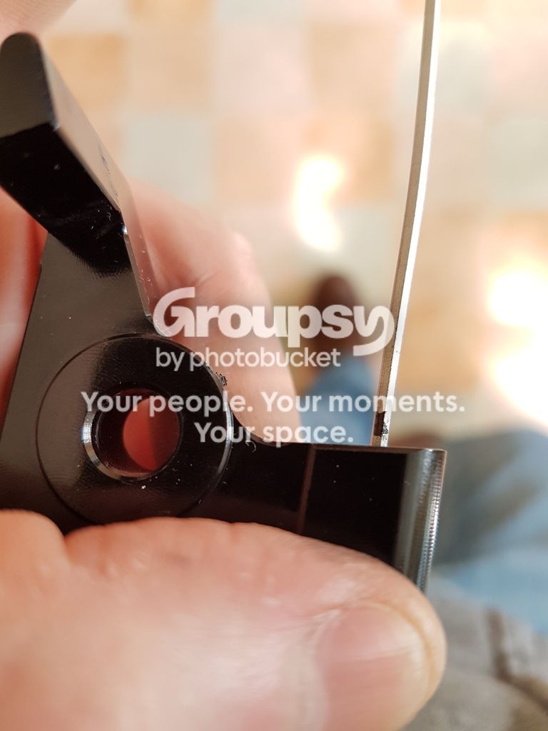

The next image shows the depth difference between depths of the original lever and the Chinese lever (The black mark is the original lever.).
When fitted you had to force it in and apply pressure to the master cylinder to get the bolt through and the brakes were deffo binding. This is a classic tell from what I've read of potential disaster. I did try to machine it out with a dremel but there was a lot of play as a result.
Personally it's not worth risking my bike or my life for a cheap lever so I've decided against fitting it and decided to keep the clutch lever and order a proper pazzo brake lever for peace of mind.
