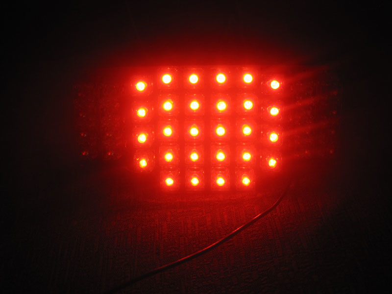

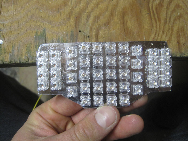

Front side of the board

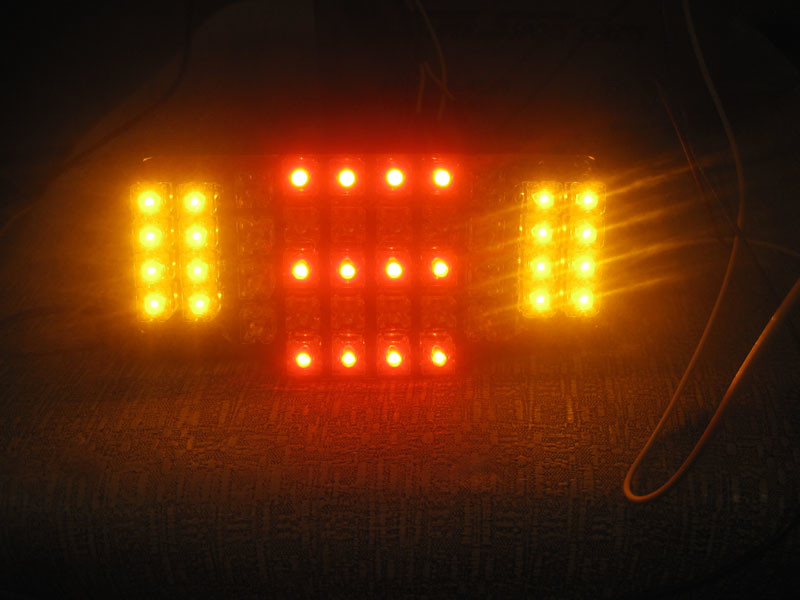

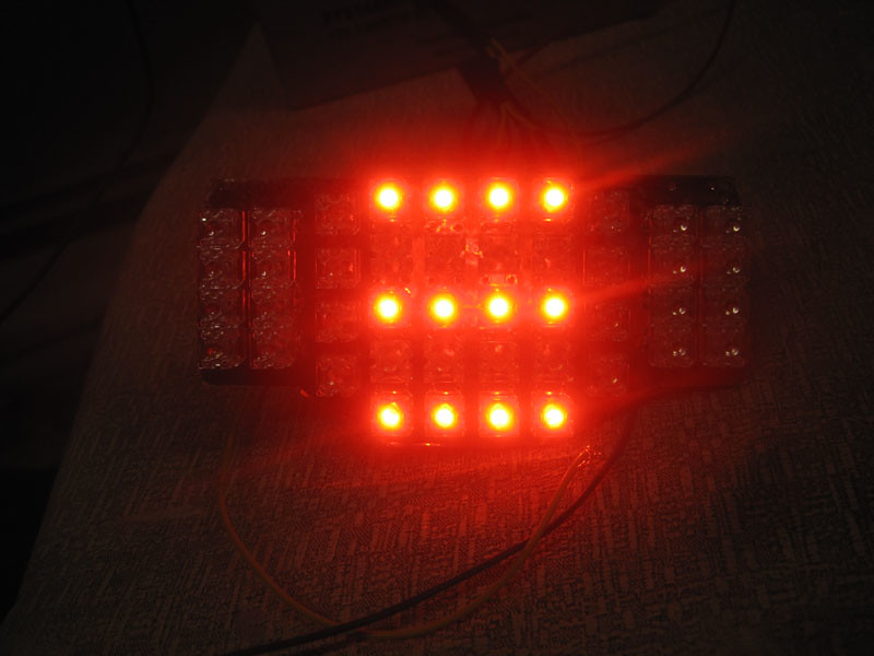

running lights
brake lights

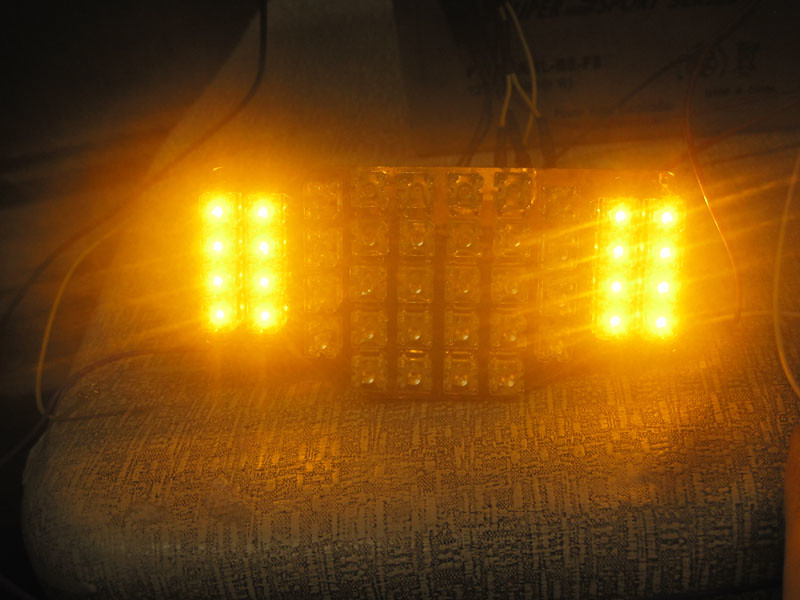

signals
running lights with signals

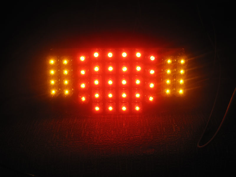

brake lights with signals

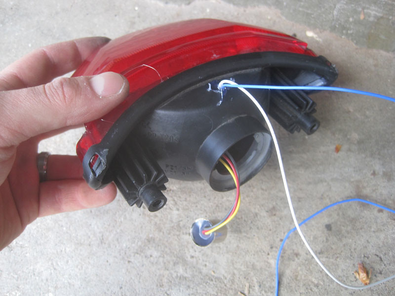

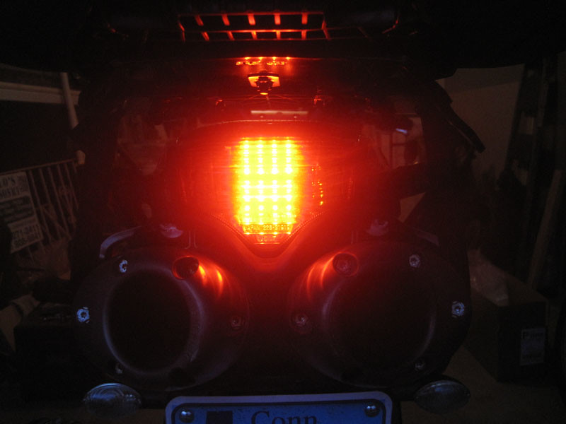

board installed in the stock housing. running light leads soldered to 1157 bulb base for plug-n-play. turn signal leads through hole in the top of the housing sealed with some hot glue.

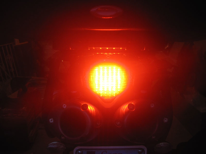

running light. the way the FZ6 lens is, it makes the 3 rows of 4 LED's look like a lot more.

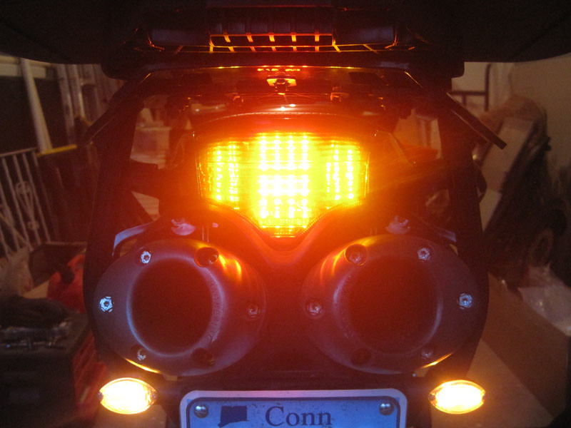

Wait, you said there was no rear signals! "I didn't even notice those!"
Ok, well we might as well extend the snipped leads on those and hook them up while we're at it.
Bright as hell brake lights.
running lights with hazard flashers. It's funny to see the quick on-off of the LED signals compared to the incandescent bulbs in the short-stalk ones. They seem to fade on and off. From long-distance, like 100+ yards, the incandescent ones are more visible than the LEDs in the tail light. Not so much as brighter, but more visible due to them being further away from the red lights. Not really anything you can do about that with the signals in that small housing.
I'm pretty happy with the way it turned out. I haven't seen any aftermarket lights in person, but I will guarantee that mine is brighter. We ran out of time last night, but we will also be hooking up her topcase brake lights, as well as a brake light flasher module that pulses the brake lights for 2 seconds before a solid on.
