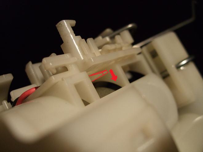

To add to the above (I assumed it ((the pump))was cleaned, likely not) you can open the pump up to a point and inspect/partially clean the screen.
Some pic's:
To separate pump into two while in the tank for MUCH EASIER REMOVAL. For installation, the pump can go back in assembled:
The screen at the bottom of the pump(cannot be replaced) but possibly cleaned:
