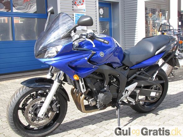

Hey guys,

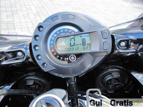

Been looking for an fz6 and came across this machine, the frame is black which, as far as I know, indicates it being an S2. But everything else, gauges, bodywork, etc is from earlier years. At least, as far as I can tell.
What's the deal here? It's not quite an S2 is it?
I didn't think you could have the black frame without new gauges?
You have it slightly right my friend.
Usually you can tell its an S2 model by the black frame but for one year only 2006 which was the last year for the S1 model; Yamaha also did the black frame on that one too so just from the pictures I'm almost 100% sure that is a 2006 FZ6 S1 model.
S1=04'-06' S2=07'+

Round instrument panel.............Wider instrument panel
Digital tachometer.....................Analog tachometer

This is just off the top of my head, *not 100% sure when they started color matching the front fender*. The 06' is a S1 with a black motor/frame.

In the US that bike is definitely an 06 but the paper work in some counties will list that bike as a later 07 model. We've seen them listed that way before and I do think it was Denmark that listed it as a year later model. :)
