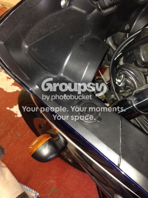

I didn't want to drill a hole in the fairings so I placed it on top of the metal thing where the cables are.
Sorry, the pic came out up side down hm....

I have a USB charger that fits perfectly there, so that spot is taken. What I am MOST interested in is the convenience of the location specifically for connecting heated gear. So for example, your spot moves with the bars, but my heated gear connections will come out the bottom of my jacket. So in that spot, the wire will need to lay on the top or side of the tank, and will need lots of slack to accommodate the jack moving.
Do you plug heated gear into yours and if so does the connection and wire interfere with riding?

I don't have a heated gear, but I do plug different wires like charging a phone in my pocket, or a helmet cam if the battery runs out in it. So if the wire is fairly long, there is no problem with steeting. I really don't see a perfect spot on this bike without drilling. But for the heated gear, do you need a real outlet, or just have a wire from under the seat?
